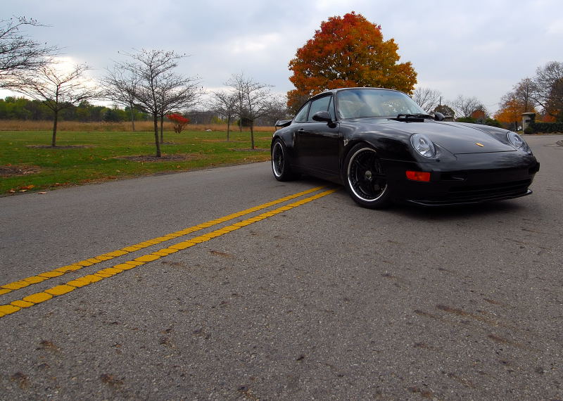

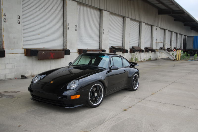

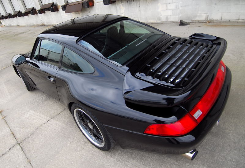

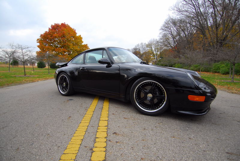

Here are a few more pictures of the car from just before the snow hit since I haven't posted them in this thread yet.
