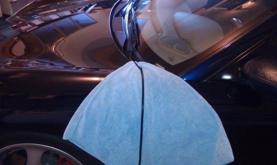

But that is what a C-tek tender will do for you. It will extend the battery life to about 4 years... just by plugging it in . Can be done in the cigarette lighter, leaving the drivers side window in a crack and plug it in a power socket in the garage.
