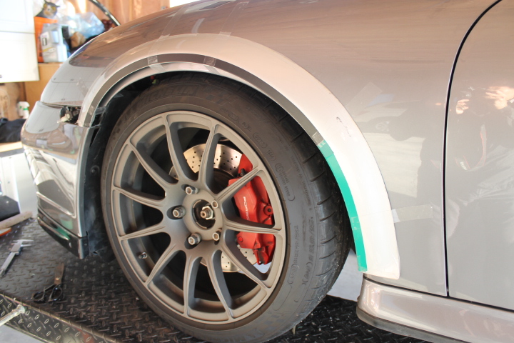

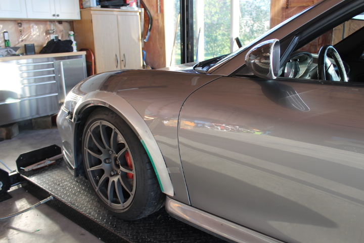

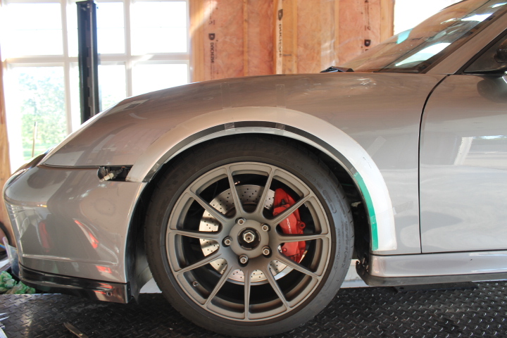

Not sure if this is high jacking the thread or adding to it. John, let me know if you feel a new thread should be started.
After staring at the front fenders of too many cars, I thought the E46M3 fender might have the fender extension needed to graft onto to the turbo fender without going through too much effort to hand form custom extensions. The E46M3's run 18" wheels and are also a fairly tight package. I found a damaged fender for $100 to experiment and decide if this is a reasonable aesthetic option. I expect anyone considering this mod wants to look as OEM as possible.
I cut off the M3 fender extension approx 2 3/4 inches from the flat vertical leading edge (the black and green tape). It has not yet been trimmed perfectly as you can see it runs long in the front and is not fitted to taper down to zero at the bottom. I'm now experimenting with the options of how to blend the bumper.
The gain is over 1" of outward clearance and 3/4 height clearance in the key area where clearance is required.
Still thinking and considering the options.

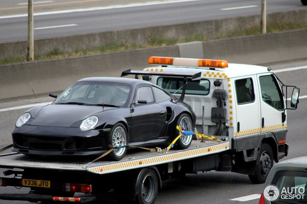

I don't recall how I came across this picture. But I have a few from different angles.
