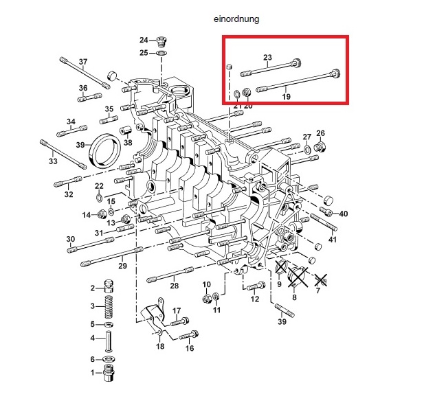

In the process of making shopping list with OEM parts needed when putting the engine together.
Was surprised to find that Porsche doesnt suggest renewing the main bolts..
Wouldnt you guys renew these?

I did not replace them. Careful not to spin those bolts when tightening. Put a little oil on the seals that go with it. You don't want to tear the seal or the oil could leak out and overheat a bearing. The seals in the EBS kit seem better quality than the red ones that came out, hopefully you have those too.
Thanks,
Will be carefull not to spin.
I am buying all seals, gaskets, bolts, nuts from FVD, so we will receive oem parts.

You are supposed to get new bolts that tighten the cams to the sprockets, I just used my old ones however. I doubt it will be a problem.

The crank pulley needs a new bolt also if you took it off. Those a known to fail and spin the pulley so definitely replace that.

I didn't replace any bolts or nuts except for the crank pulley. My kit came with new washers for the perimeter bolts. You will need:
main bearings
rod bearings
nose bearing
IMS bearings
cam bolts
crank bolt
Loctite 574
valve cover sealant I used Yama bond 4
anaerobic sealant with activator spray I used Permatex
timing chains
​red Loctite on crank pulley bolt
