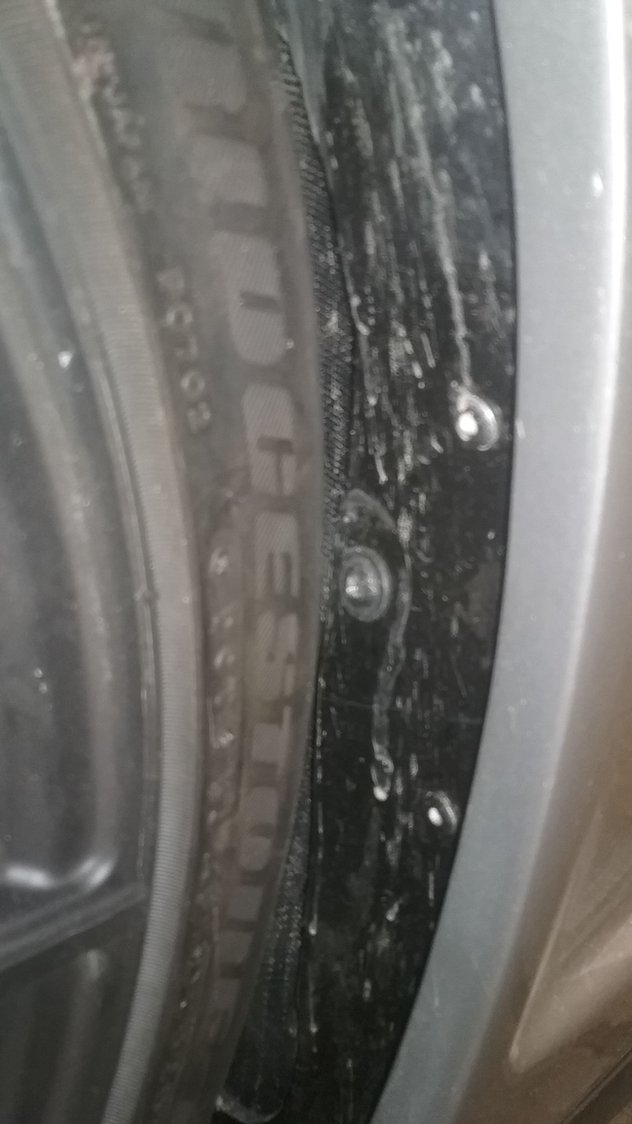

Here are 255/35/19 (26.0 tall) at a slight turn with missing the radiator brackets. No more room for something 26.7 tall. I may even mod mine more this winter as well.

brnrdtns Is a GOD !brnrdtns Is a GOD !brnrdtns Is a GOD !brnrdtns Is a GOD !brnrdtns Is a GOD !brnrdtns Is a GOD !brnrdtns Is a GOD !brnrdtns Is a GOD !brnrdtns Is a GOD !brnrdtns Is a GOD !brnrdtns Is a GOD !
Yah that is close. The 225 will fit but I want to go wider. I hate it when my car plows a tight corner.
