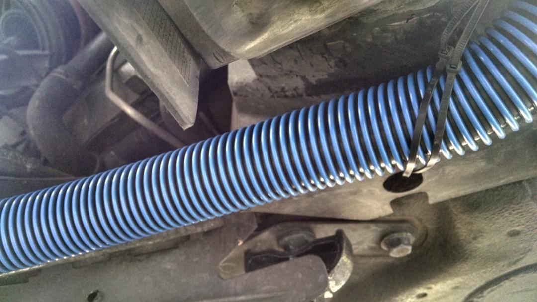

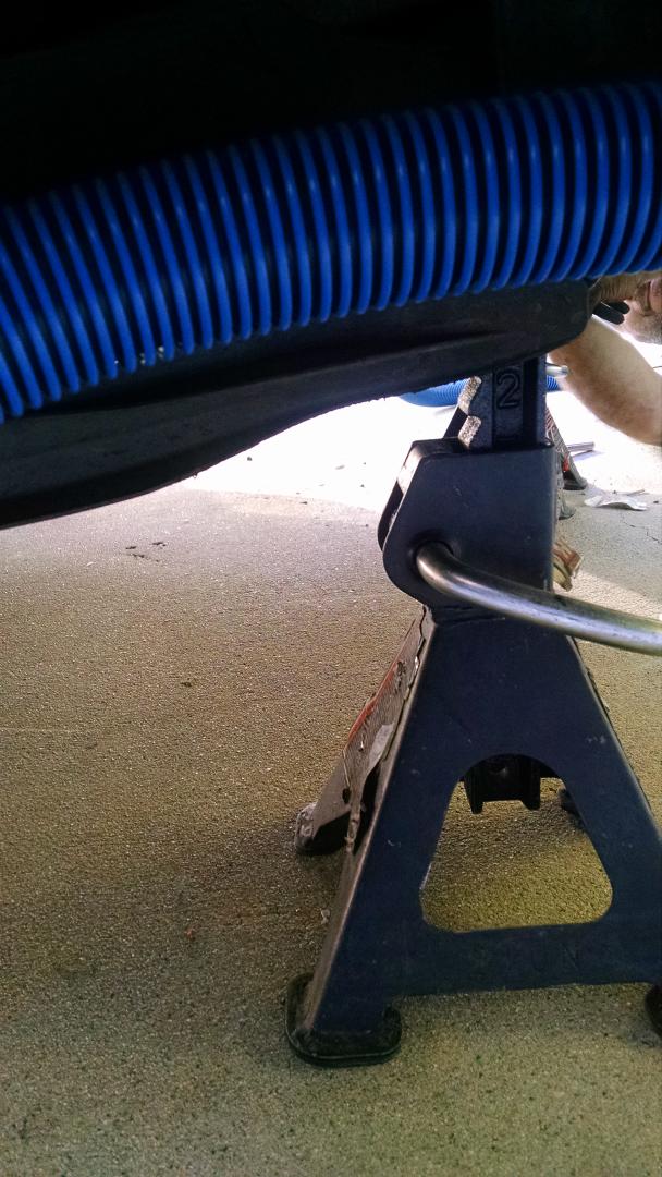

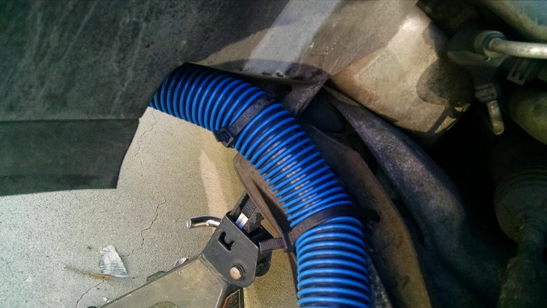

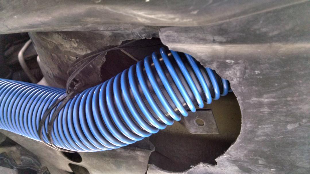

someone? asked for pics of the hoses to the calipers which i found:
Name:	AAv_rWW0wtkb6TQNcYoseLC9M5FeS0Chu1lLyu-EWhj4xCeH9KsLifH8WS6wdqynT1g-FwmDe56KmBQk_qUk14Y~.jpeg
ID:	468655   Click image for larger version
Name:	AL3DjmeYLkbgIH7f2kcko1Gn7CaRrOqJHY0u6bw2ikQKFnEZTSmCtp7zQF9pFhdS4RCpiV_BKPLxuIwkDZoaQpM~.jpeg
ID:	468656   Click image for larger version
Name:	APuyfYfHe-qLgQ4ek1Pi8Bxb5CSI3HVcnh0RbuDAHwAJG_lxiJ43H4i5GFJVFjjT9FWdD2YfrtVD4VHulXurG_I~.jpeg
ID:	468657   Click image for larger version
Name:	AOQdpb5yJrmxyzwjw3TXGsE2AfLSNkE8xLe2IC_jzLDL04cYnGY23Cl7e8kqoJZHrHP2eppUKRyQLAgnh71OnDI~.jpeg
