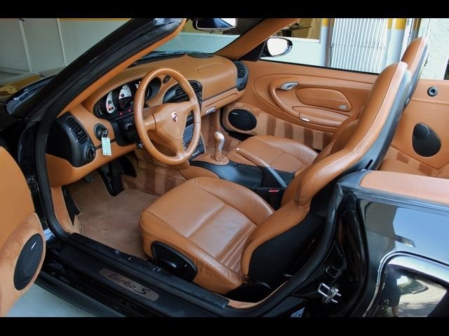

Oh - and here a couple of pictures I lifed from the Dealer Site

Nice looking car. I would go ahead and get the free update, but not spend more money on GIAC. If you want to upgrade the tune further, I would go COBB.
