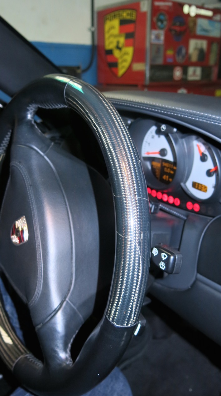

Hummm , my steering wheel is cracked at 12:00 o'clock position and it bother me...I'm tempted.....

Go for it... It's hard to screw it up... If you don't like it on the first try, just sand again and re-apply. Stop when you love the results. CF is very forgiving to work with.
- Just make sure to tape off the areas you do not want the resin to stick to.

Thanks Slider, there are so many details on this thread , I think I just need a little push ;-) Thanks also to the OP!!!

If it were that easy everyone would be doing it. While not rocket science it does take some work and time. And if the cracks are all the way through care must be taken to ensure the carbon cloth isn't disturbed.

I think most people don't do it because they think it's really hard. If they totally screw the pooch, they can sand off the CF too and re-apply. People think CF really expensive... it's about $40 a yard - that's enough for the entire interior of a TT. ... and if it's not quite perfect - it still looks better than the cracked one.

The grit depends on how much you need to fix the resin. Work your way up and, when it all looks good, end with 1000 grit and spay with automotive clear coat.
If you want to be sure your repair doesn't turn yellow over time, the clear coat is a must.
Edit: Always wet sand... you don't want to be inhaling CF dust. (and the sandpaper lasts forever)

Start with 80 and work your way up to around 6-800. No need to go to 1000 and I wouldn't as there's no reason to and the clear needs to bite into something so I would stop around 800.
Epoxy resins have also come a long way since the trim was made for these cars and many are very UV stable by themselves. Clear coating it will ensure it will last for a long time but depending on what resin products are used it may or may not be required.
Wetsanding will keep dust to a minimum as well as not clog up the paper too much.
