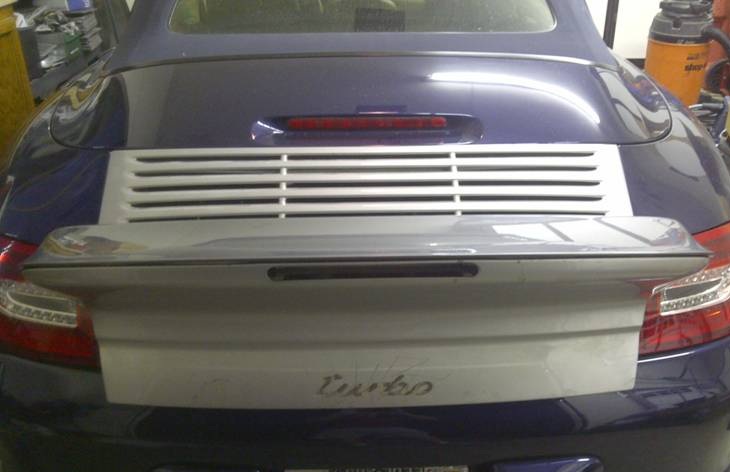

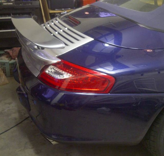

Fixed wing for 996 turbo decklid was my choice since I wanted to keep the stock airbox.
Great idea! Looks outstanding. The Turbo deck lids/wing assemblies are easier to find and coming down in $$$. Nice OEM upgrade.
You mentioned in your other post that you did not cut/trim the top, did you have to trim the sides? Do you have any close up pics of your customized latch setup?

The sides didn't need any trimming in my application but the hinges did. I think you need to test fit your decklid to understand the trim needs. Latch was L brackets secured through the layers of fiberglass adjusted to hold the stock strike-plate. I can take one soon.

So it is the bottom of the deck lid that gets cut/shaved down?
I was told it is the top end that is long. I am dying to add a spoiler to my C2 and the ones I like seem to always be made for the turbo.
I have been told it can be done two different ways. Cut bottom approximately 2" and the top 1/4". Or pull the deck down an est. 1/4" and cut the bottom only. I have not done either yet! I will post my experience with pulling down the deck lid and cutting the bottom only if possible.

I cut only the bottom (about 2" strip or so) Take a few progressive cuts with test fit and using masking tape to draw your line to match the bumper curve. Play around with the hinges bolt down and to the decklid to get best fit.
