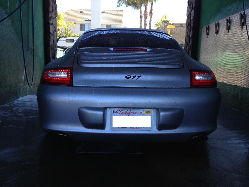

Mine is pretty similar to yours but a coupe. I added some exterior mods. Sideskirts, Turbo front bumper, LED tails and the simple 911 badge to personalize it a bit.
