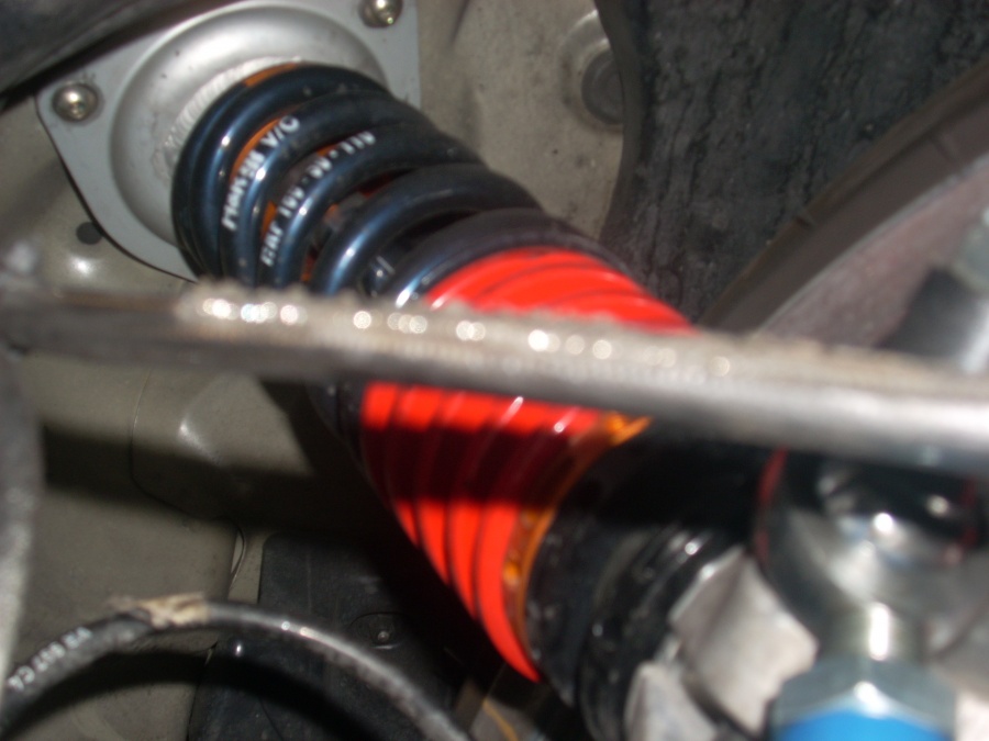

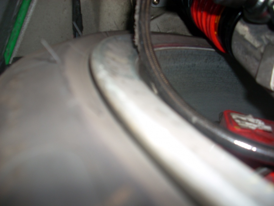

Pictures of the damaged Hoses
Here are some pictures...
