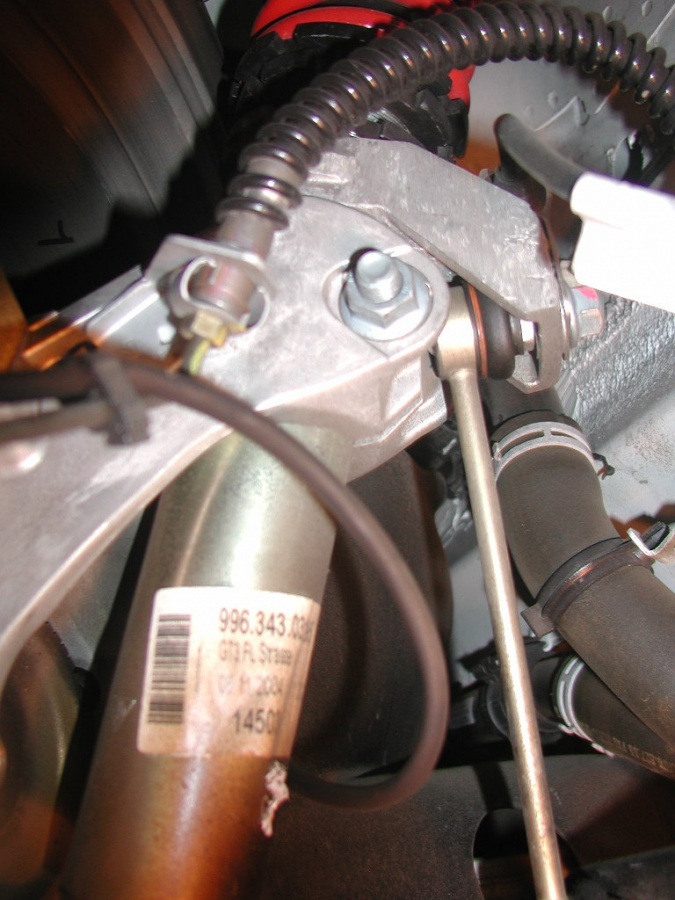

What does the OEM GT2/3 front drop link look like? Anybody have a pic...

here is what the stock GT3 droplink looks like...

GT3 Chuck, thanks for the pic. I bet that's the same size as the Bilstein.

Here's the new 997 GT2 drop link...looks just like my twiggy Bilstein drop links. Rubber bushings. So much for "advanced suspension."

here are the Tarett links (just a tad beefier):
