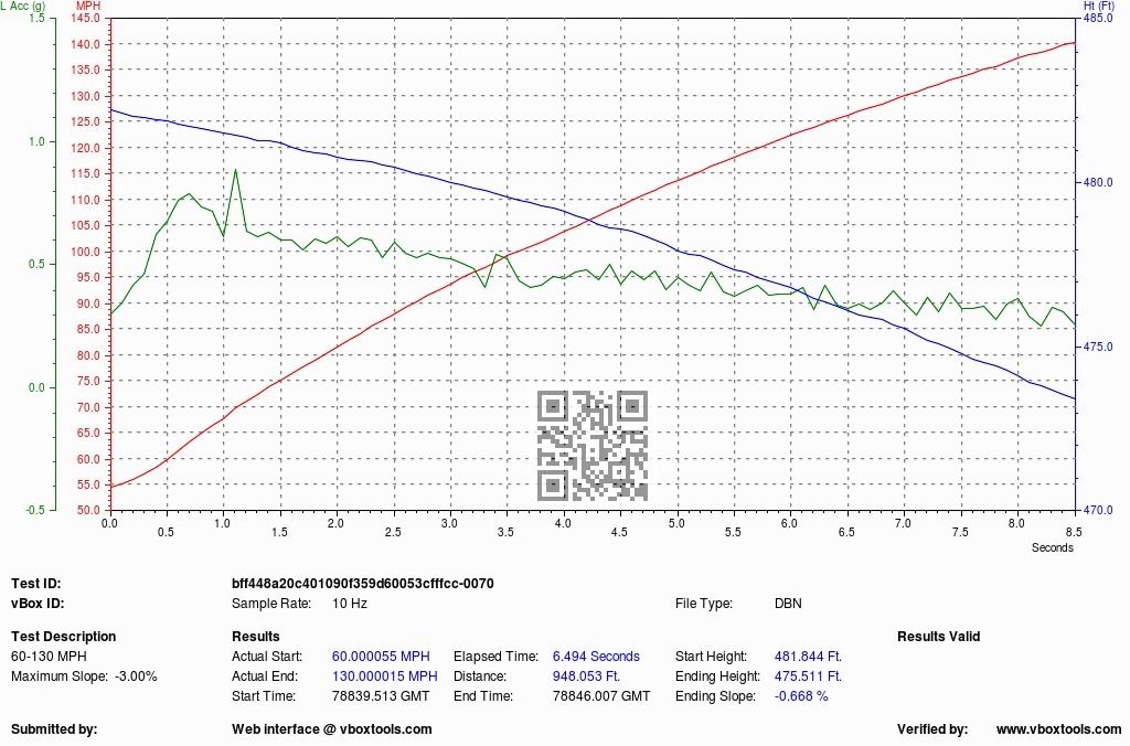

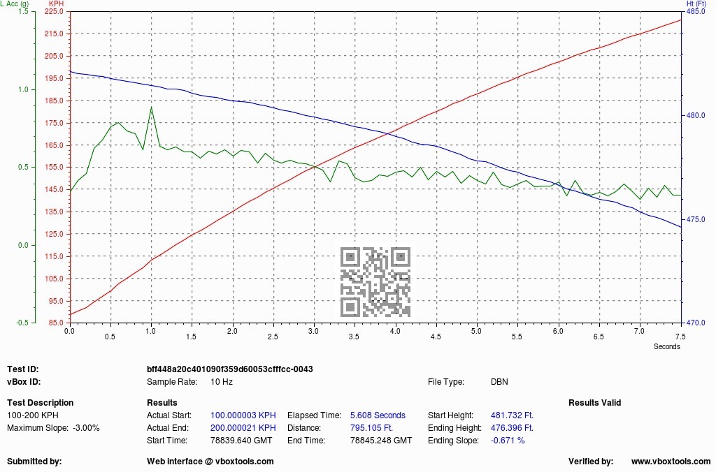

So I just finished first day at Shift Sector. Airstrip events are usually great places to run other cars but 60-130 records are never broken because density altitudes are high and the airstrip is flat.
I did a run around 2pm when temps were upper 70's and DA was measured about 1,800 feet. I ran a 680 wheel stage 3 supercharged C63 owned by JRCart from a 45mph roll (vids to be posted soon) and pulled on it pretty hard in the mid range. Very surprising.
I look at the VBox after the run and it says 6.5 and I just uploaded to PBox Tools and there you go 6.49.
On a 50 degree morning with a negative slope high 5's are now easily attainable. Just need to wait another month for things to cool down a bit.
from vBox Verify 60-130 mph and 100-200 kph:

Brilliant Adam.
I just got a 6.55 in cooler temps and -2% slope and so I will NEVER catch you.
I see your splits are good so in a DA=0 you will be 0.3 secs quicker and a 2% slope another 0.2s faster.
Epic for a basic bolt on car that also does 0-60 in 2.6X secs
