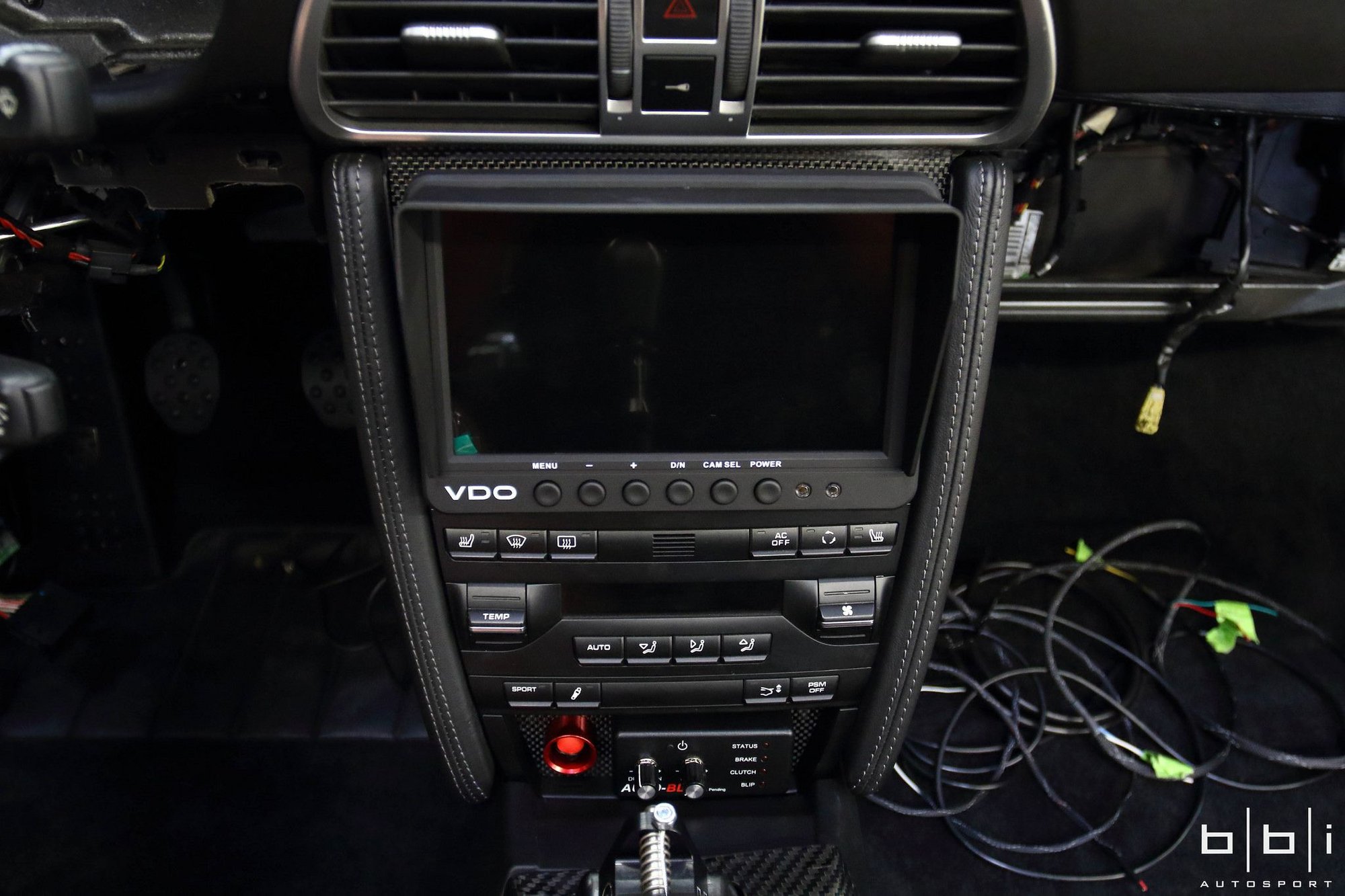

Powderhound: You will like this (note how short the front shock tubes are):
