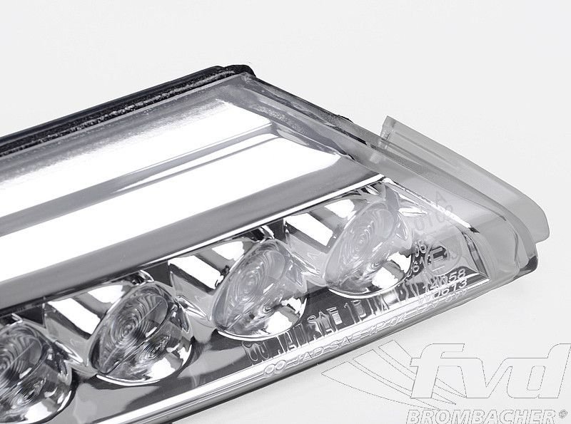

I have Vivid DRL's installed on my 997.1 from the previous owner.
They work fine, and look pretty cool.
Problem is they have started to get cloudy. I have a spare set of OEM lights, and the comparison is pretty stark.
Has anyone experienced this with their lights, or have you had any success in cleaning them up with one of those headlight restoration polishes.
From what I've read I will need to pull the front bumper to remove them so prefer to avoid that until I exhaust all options.
I looked on the Vivid site, but they are no longer sold. I do see Speedart lights listed for a whopping $2400! which isnt going to happen.
TIA

Hard to tell from the pictures but it seems like a simple polish and paint coating should fix her good. It seems like the lenses were cheaply made with no coating on them like your factory headlight and turn signal lenses.
Just pay your detailer. Or do it yourself preferably with a machine polisher along with Meguiars M101, M105, Ultimate Compound or any other compound or polish you may have available. Or i'm sure polishing by hand would work too with a regular cleaner wax. This will remove the oxidation. Then coat with a paint coating such as Opti Coat to make it last.

You really should get a detailer or headlight restoration specialist with the proper machine polisher and polish to give you a crystal clear lens. It doesn't hurt to try by hand first though.

i have the vivid ones & had them tinted before i put them on ,now several years i hated the tinted look & had one of those headlight rest co come to my house & polish my .2 headlights that i put in & he was able to remove the tint from the drl's while there without removing the bumper.

Car is due to a solid detail. Removing the bumper is the last resort.. not in the mood for the headache of doing that/risk of damage to it either.
