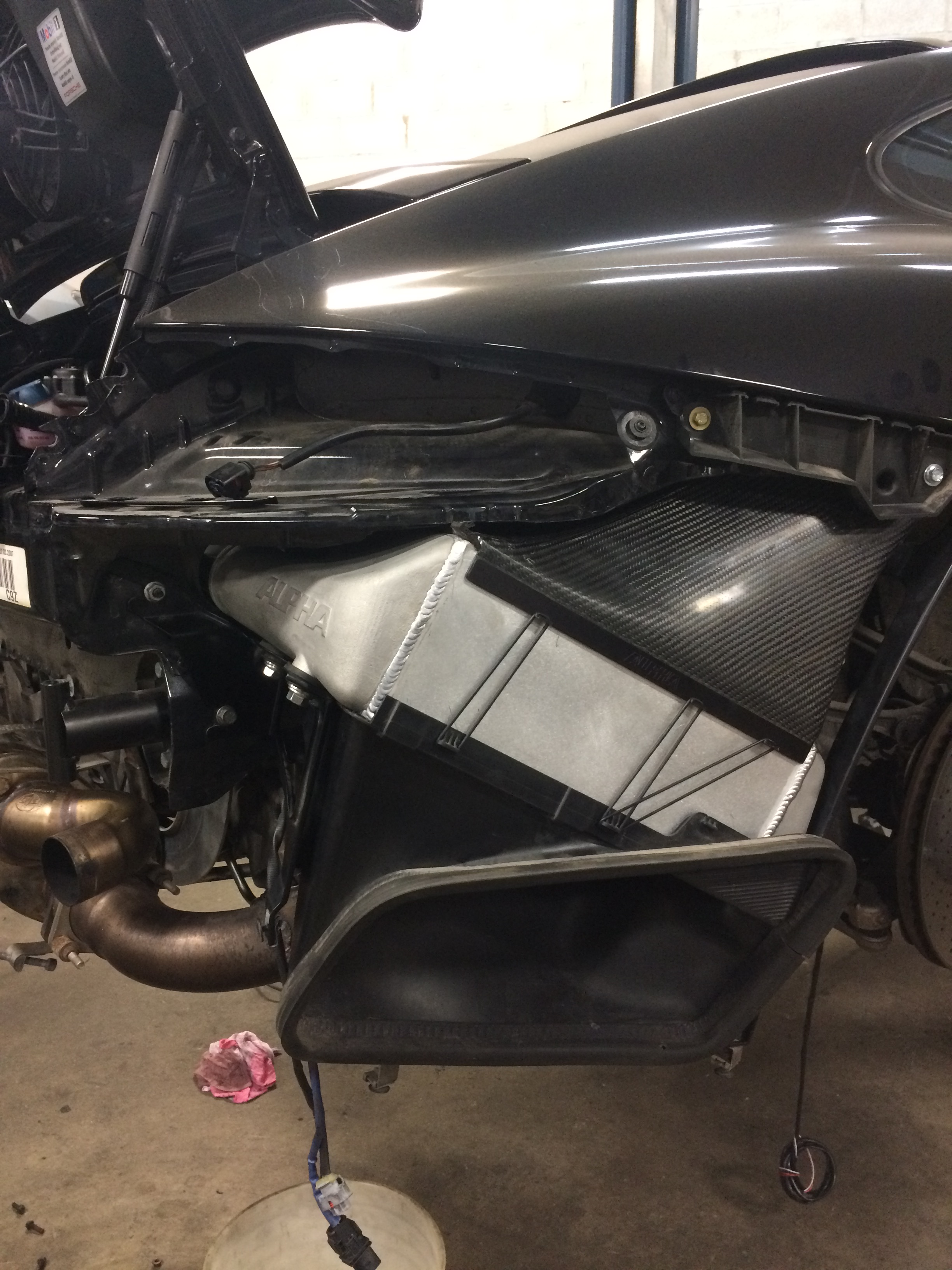

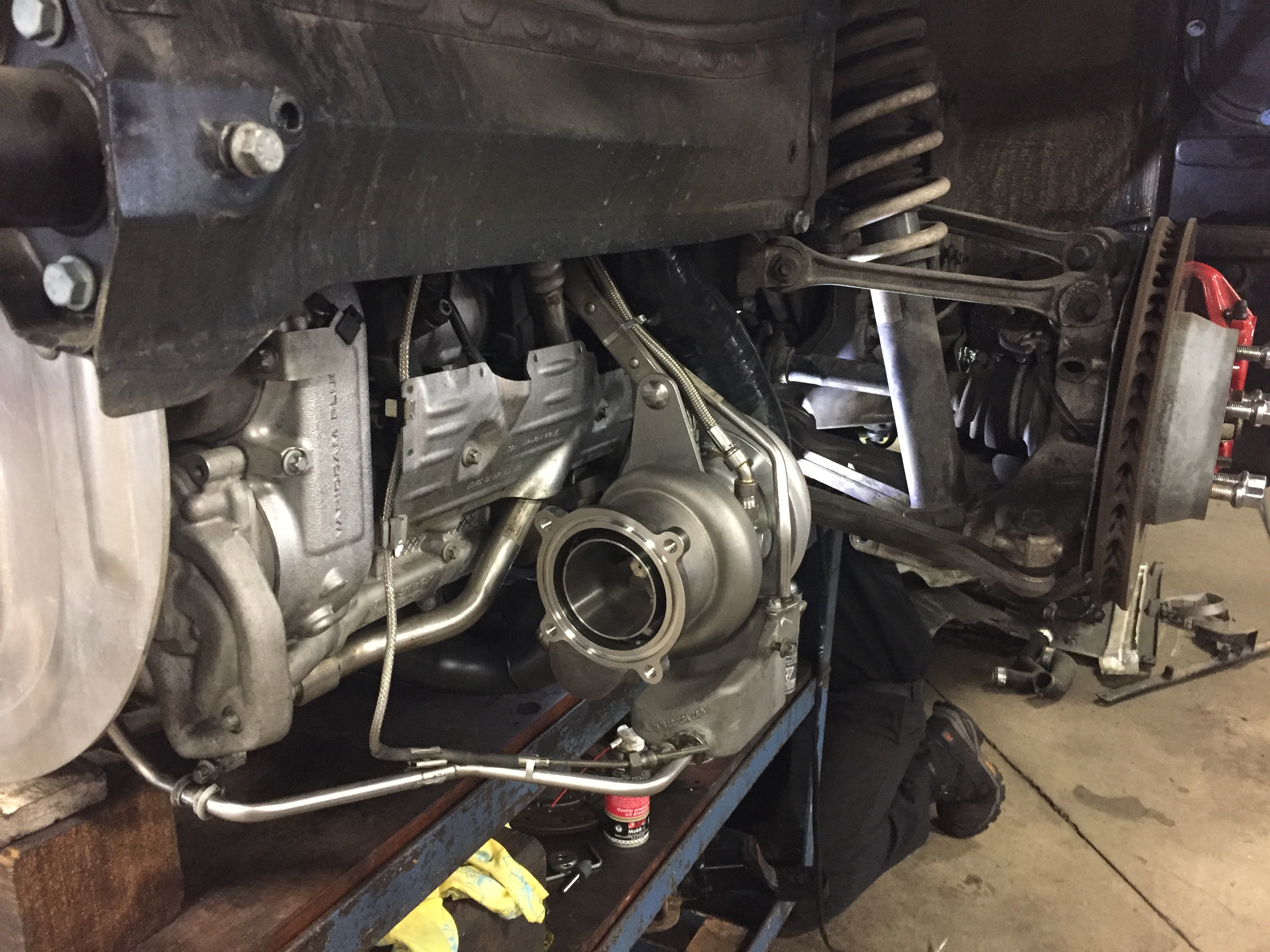

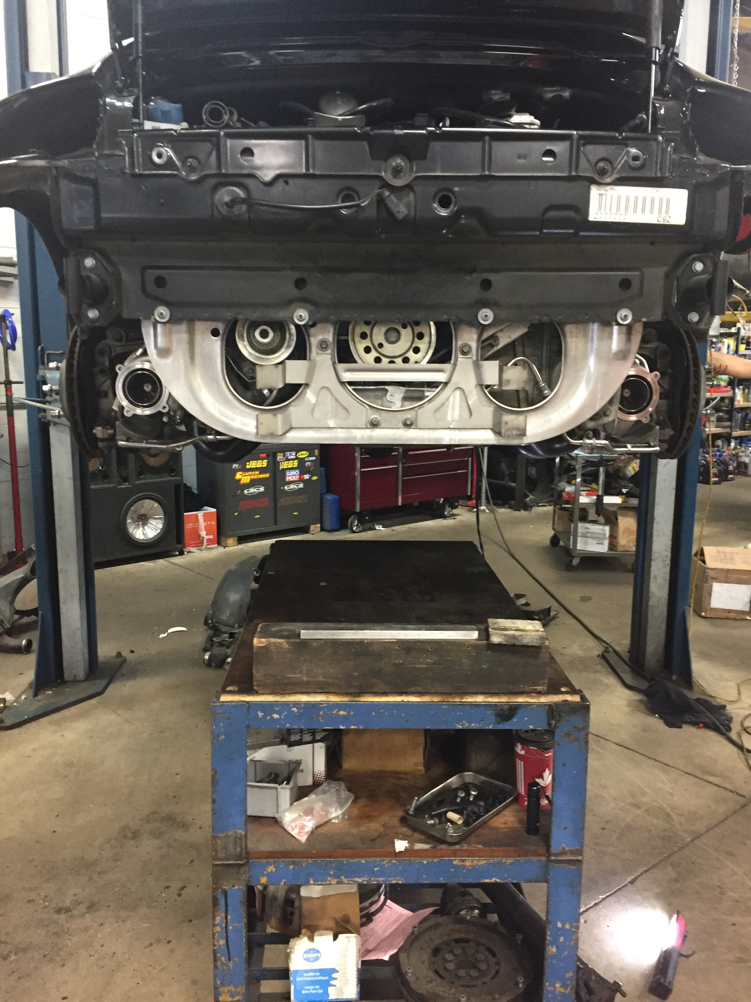

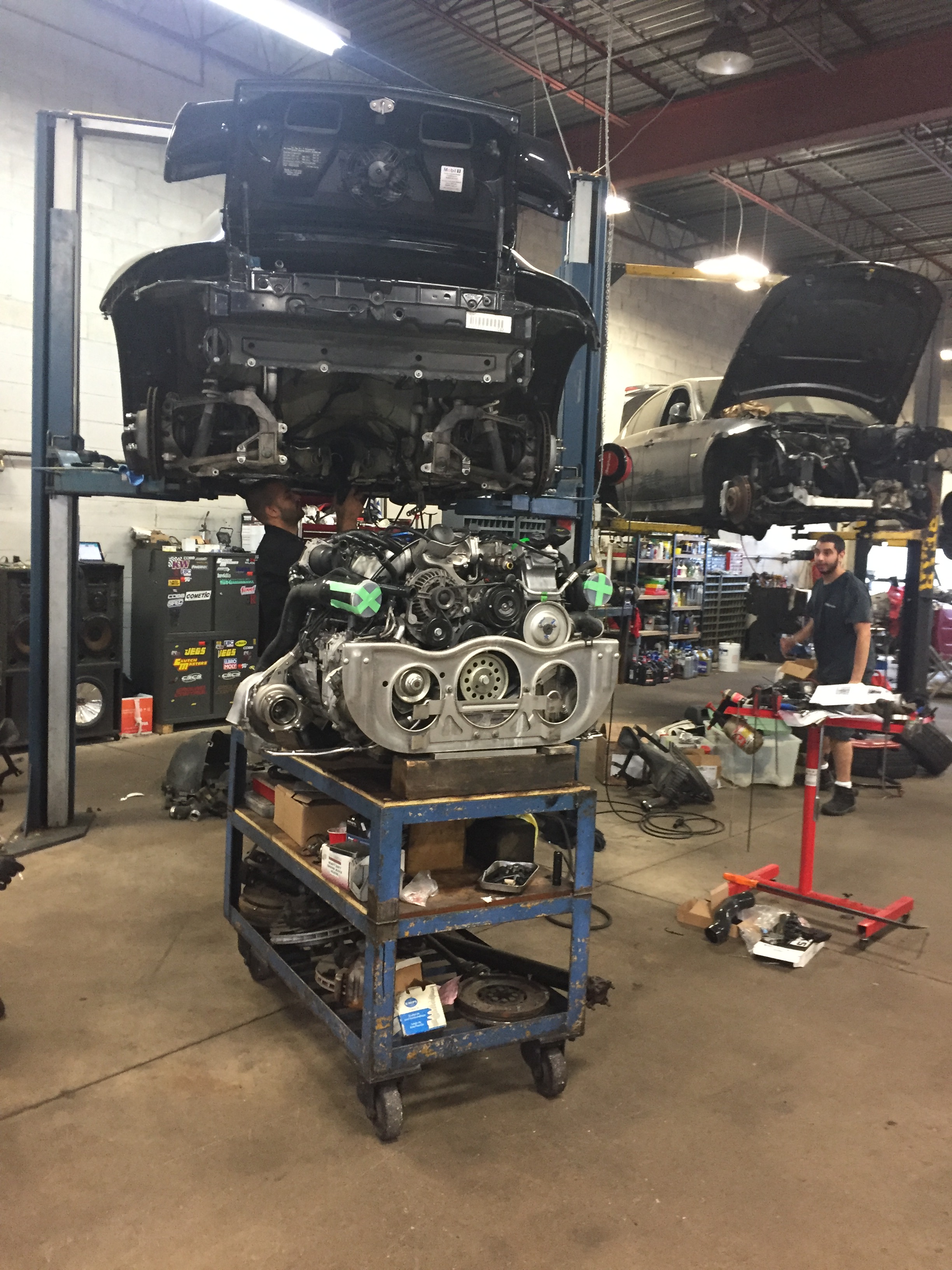

997.1 TT finished installing AMS Alpha 9 kit
Its been an anxious few weeks waiting to have all of this installed. Everything is now in the car and awaiting judgement day on the dyno.
Car is a 2007 Techart, tiptronic with the full Alpha 9 kit and the new Tial 3076 Xona rotor turbos. Also has 1000cc injectors, 82mm IPD plenum and throttle body. Car will hit the dyno with fvd headers and catless Techart exhaust as I await the inconel headers and titanium exhaust ordered from Unobtainum welding.
Car will be getting tuned in Toronto, more than likely on an AWD Dyno jet. Still trying to button that down, hopefully we are on there soon.
Been scouring the internet for similar set ups, been able to find few manual cars but not many tiptronic ones. Would be curious to see what similar tiptronic cars can sustain safely. If you have any insight in that would be great to hear from you.
Prodigymd thanks for putting up with my 1000 questions over the last few months and helping me source all of this.
Also very curious to see in the next month or so what power difference if any the inconel headers and titanium exhaust will make vs the fvd/catless techart that it will hit first the dyno with.
Favourite part of this entire kit has to be those intercoolers, what a shame to put the bumper over those.

The full Alpha kit was installed by KTM Motorworks in Toronto. Cant say enough about Kosta the owner. Meticulous mechanic, had to wait a while till he finished some big turbo builds on a pair of 335 BMW's that converted to a single larger turbo, putting down some surprisingly big numbers that I still cannot believe. Keep joking around with him that he should have became a surgeon not a mechanic. Did a slew of things while motor was out in terms of maintenance and preventive measures. Serviced tranny seals in addition since we had it out. Cant say enough about his level of expertise and thoroughness.
