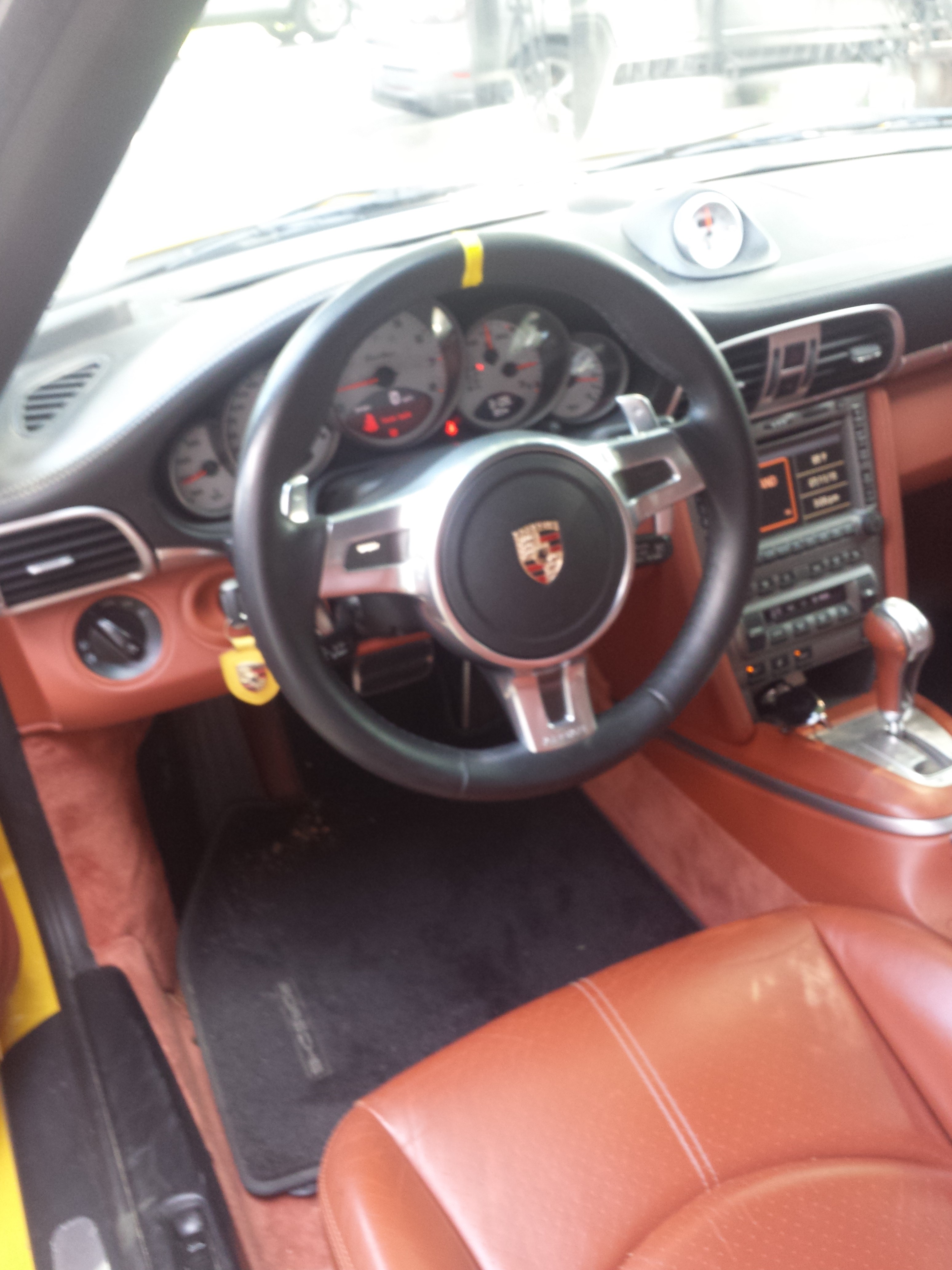

I’ve install the PDK steering wheel on my 2007 turbo in summer 2015 . Steering wheel, airbag and module for the wheel-99761328901. My car had a Tip. sport steering wheel without multi-function controls.
It was plug and play, everything was working right after the installation from the start of the engine, no programing was necessary in my case. There is a “sport” sing on the left side of my steering wheel when I activate “sport mode” as well No errors on dashboard and the horn is working without any issues.

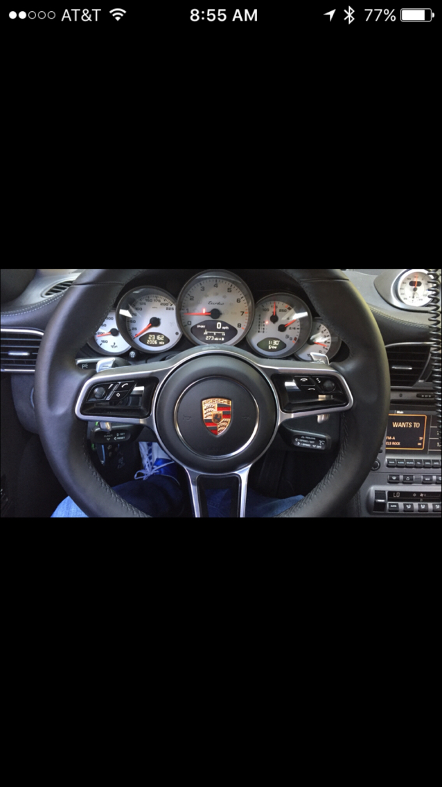

I've updated to the 997.2 then to the 991.2. For the 2009 upgrade, I bought a used module, and it was plug and play.
If you've already done the module change required on pre2009, the new wheel paddles and airbag work. However, no one has figured out the switches. I paid $500 for a used wheel and $600 for a leather airbag.

Right... the multifunction. I could not, nor has anyone else. Paddles work fine and have a shorter throw than the 997.2. The throw is like the GT3 997.2 wheel, and it allows you to see the gauges better.
