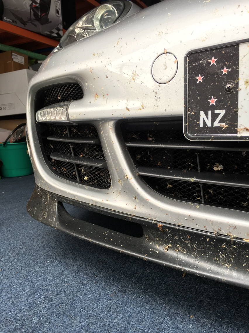

Mesh installed in the front bumper helps a lot to reduce this.
