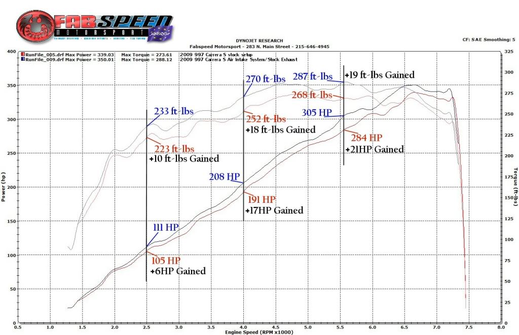

Here is a dyno graph from a 2005 997S before and after the Fabspeed air intake upgrade and BMC airfilter.
Here is a dyno graph from a 2002 996 3.6L before and after the Fabspeed air intake upgrade and BMC filter.

We tried a couple different intakes on the new Direct injection 997 and were able to make the most hp and tq with the dual Fabspeed Dual cone air intake with full Carbon Fiber heatshield. Here is a dyno of the 997.2 direct injection before and after Fabspeed Dual Cone Air Intake

However, can you explain why your red rubber tube is better than the stock black rubber tube? I know that it's "smooth" on the inside, whereas the stock tube is ridged, so your piece removes any turbulence. And I understand how the red cap removes the Helmholz resonator. But is that it? Why would something so simple make the difference that your dyno graphs are showing? I guess I want to believe it, but am just skeptical.
I've got the EVOMS cold air kit on my '05 997S (along with many other mods, including your Fabspeed mufflers), and it's got several clear advantages over stock. The EVOMS kit is also smooth on the inside, but offers a different filter which acts as a venturi. It also offers some audible sound benefits.
And yes, your's is $225 vs. $595 for the EVOMS, but I just can't see how the smooth hose is that much better than OEM. Please, help me see the light.
Also: why are the airbox components in your pics wrapped in tin foil? Is that meant to keep the air flowing through cooler?
Thanks!

I agree with Cattman. Please educate me further regarding your kit for the 997. Could it be just the Air Filter that is making the majority difference?
I was very happy with my cold air kit I got it as soon as it came out. Never really tested the gains but the car did seem faster on the butt dyno and it sounds better without the helmholz resonator.
You know alot of the gains that the dyno is showing IMHO is from the BMC filter, not the Fabspeed part.

Here is the difference between the stock hose from a 997 and the Fabspeed Silicone Hose.
The Porsche factory 996 and 997 hoses are corrugated rubber hoses. Fabspeed silicone 4 ply hose is very smooth internally to eliminate boundary layer turbulence and results in an increase in airflow to the engine. Fabspeed eliminated the small side rubber tube that connects to the Porsche muffler/resonator on 996 and on 997 cars.
If anyone is near the Philadelphia area feel free to stop by our facility with a 997 or 996 and I will be more than happy to install a cold air kit with BMC filter and do a before and after dyno. You are more than welcome to contact the guys at BGB Motorsport and see why they use the Fabspeed cold air kit on their race cars. (The wrap on the Factory airbox is a thermal wrap to help keep the intake temps down even more)
The Fabspeed cold air kit gives you great sound by removing the Helmholtz resonator, and when used in conjunction with the BMC air filter you get a nice increase in power through the entire RPM range.

Do you have any dynos showing the gains with the Cold Air Kit alone, that is w/o the BMC filter?
The only dynos that I have are with both. The only cars that I have dynoed have had both installed, but the next time I get a car in I will do a dyno with just the Cold air kit.
