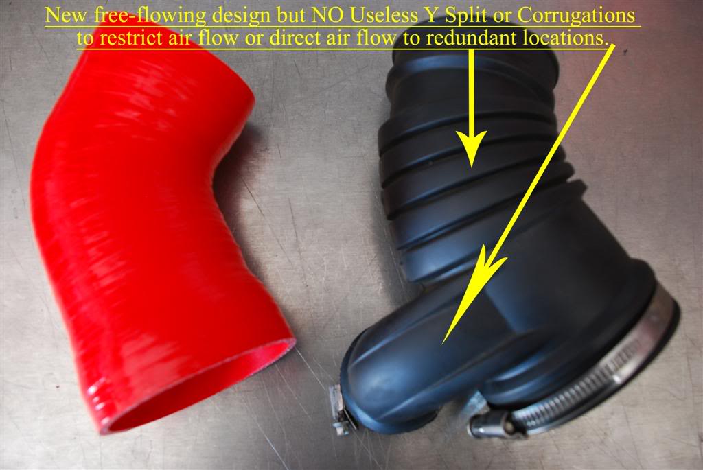

Check out the comparison between the Factory Y hose on a 996 or 997 versus our Fabspeed mirror smooth silicone which increases power and sound when used together with the BMC air filter. You can clearly see why our Intake hose flow better and makes an increase of 8+ HP through out the RPM range on a 997 S. Take a look at the pictures below. Let me know if you have any questions.

Alex, that tube intake design looks great!
+1 on the smooth walls ...

Alex - thanks for the pictures. Do you have any data on gains using your intake tube + resonator cap without an aftermarket air filter of any kind? I think that is where the majority of curiosity resides.

Thanks guys, if you do just the cold air kit upgrade which is the hose and block off, you will see approximately a 4-5 HP gain without the BMC filter. The BMC filter makes a big difference because they complement each other when done together and you see the full potential of hp gain.

Alex,
I believe what dndodd is asking is would Fabspeed be willing to fabricate a tapering hose that will fit the X-51 airbox, tapering down to the stock 997S or 997 TB for a smooth transition.
Quote:
Originally Posted by Alex@Fabspeed View Post
The hose only comes in one size and it fits and mates up the same on either model. There is no different hose for the X51 car or a different airbox that was put in.
