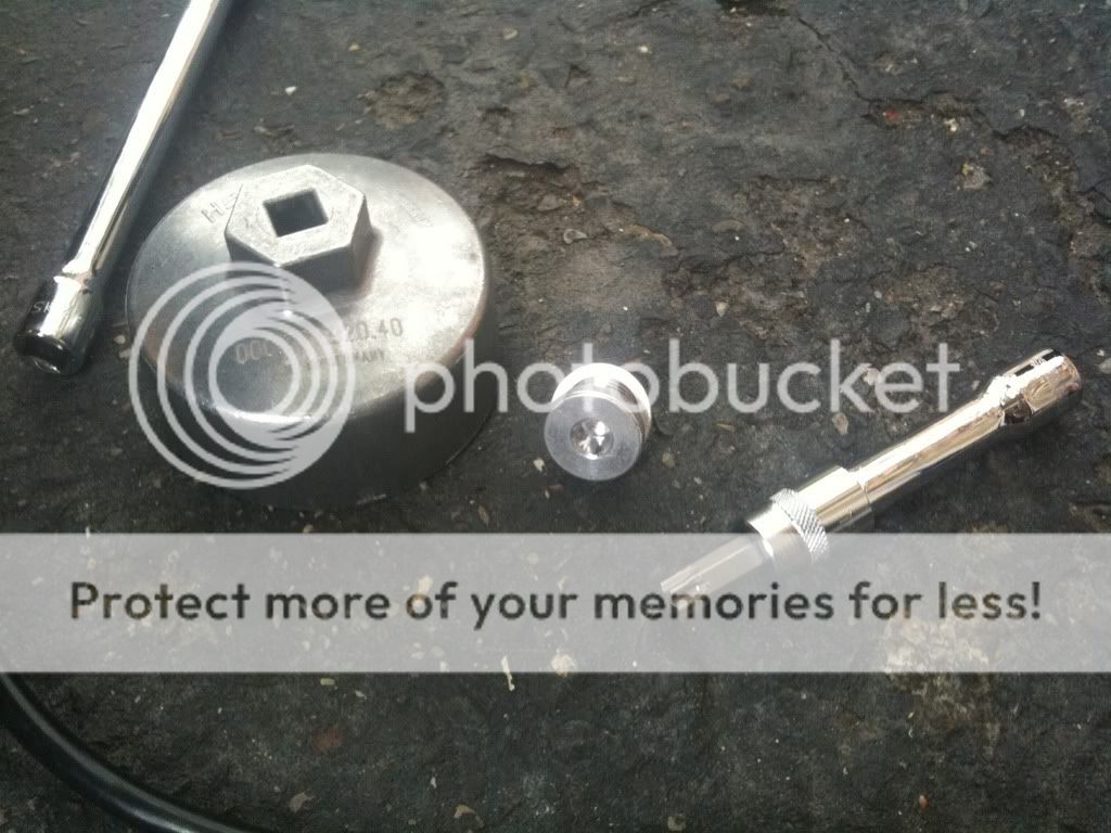

T50 Torx is needed for the drain plug(s) and 10mm socket to pull down the front plastic shield (NOTE: you only have to remove the front shield - not both.)
Click the image to open in full size.

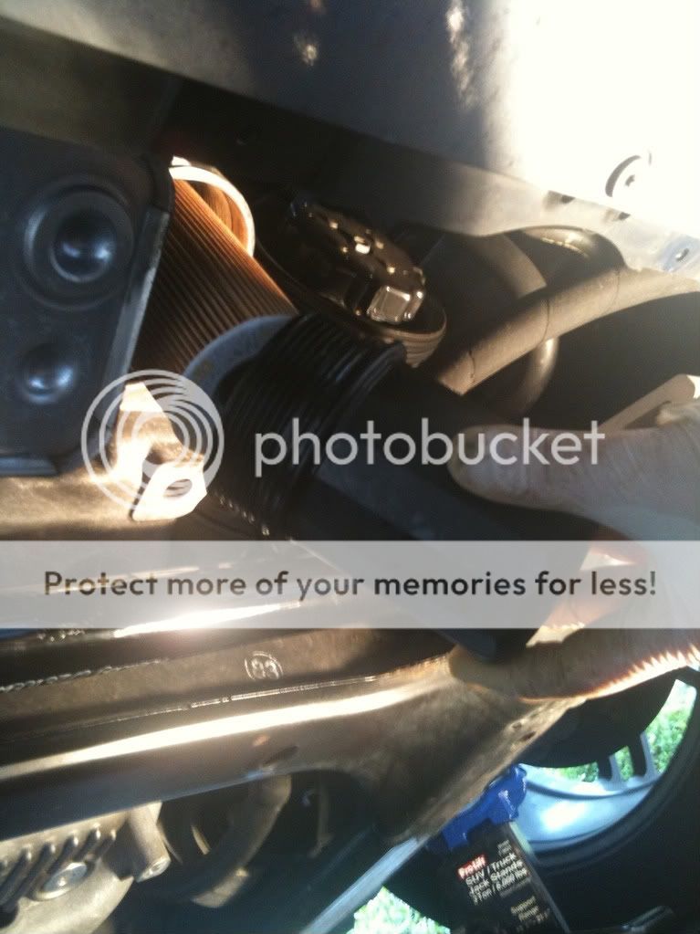

After the shields are removed, you can see the oil filter housing (removed in this pic) and oil drain plug easily. There is actually a second drain plug at the back of the engine about 12 inches from the first drain plug. When I removed the second one after the first stopped dripping, nothing came out. To me, its a waste to remove the second plug. NOTE - YOU SHOULD REPLACE THE DRAIN PLUGS WITH EVERY OIL CHANGE!! They are made of aluminum and strip very easily.

New filter install - You just push it up over the male end, grease the seal around the housing, screw the oil filter housing over the filter and tighten with the wrench.

Great write up.
I would suugest using a hex bit rather than a Torx bit to remove the soft aluminum drain plug.
The drain plug is a metric hex bit. Using a proper bit (instead of an Allen key or Torx bit) will prevent stripping the plug.

Actually I have the hex, Porsche told me torx and 2 write ups on renntech said the same. When you look in the hole you can see the extra torx slots.

The big round tool is needed to take off the oil filter housing. I bought mine from Suncoast porsche - believe it was $20. I also bought the oil pan plugs and washers from them. Overall, these tools are cheap and Suncoast is always great with their delivery.
Do not try to change ur oil without this tool and without new drain plugs! The plugs strip and you will be stuck if you do not have an extra handy.
