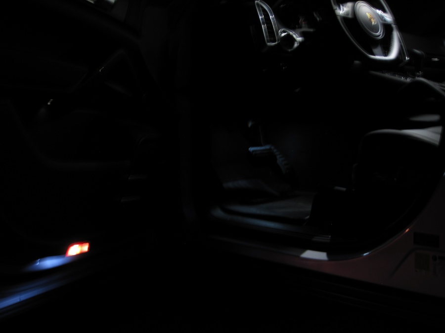

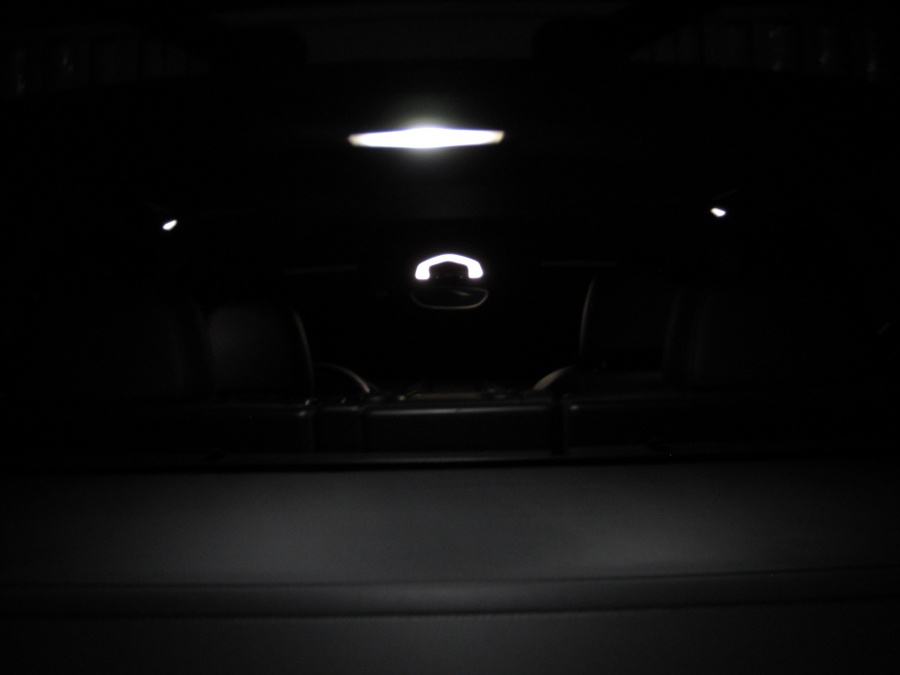

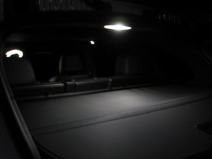

some pics of the lights, my point and click probably isnt the best
camera to get night shots with. The door and footwell look blue in the pics but are more white and closer to the OEM stuff in person.
