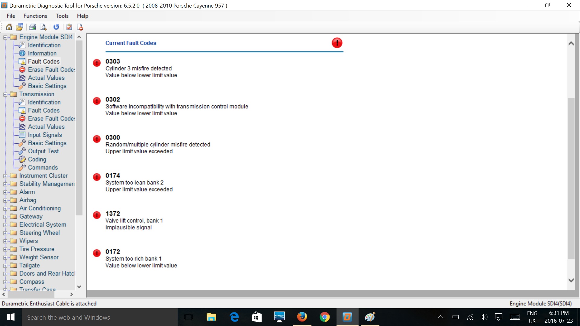

I have the fault codes shown in my attachments. The software incompatibility with transmission control module fault is a new strange one that only came up after the 2nd and 3rd time of having top end power loss with MAF fault codes … like it was suffocating for more air, but shifted rough in anticipation of a rapid RPM climb. At the moment the transmission is both auto and manual sport shifts fine.

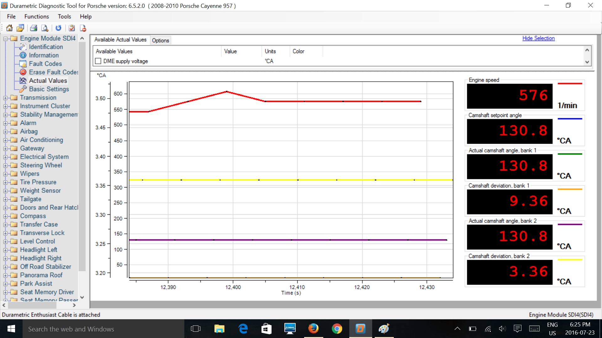

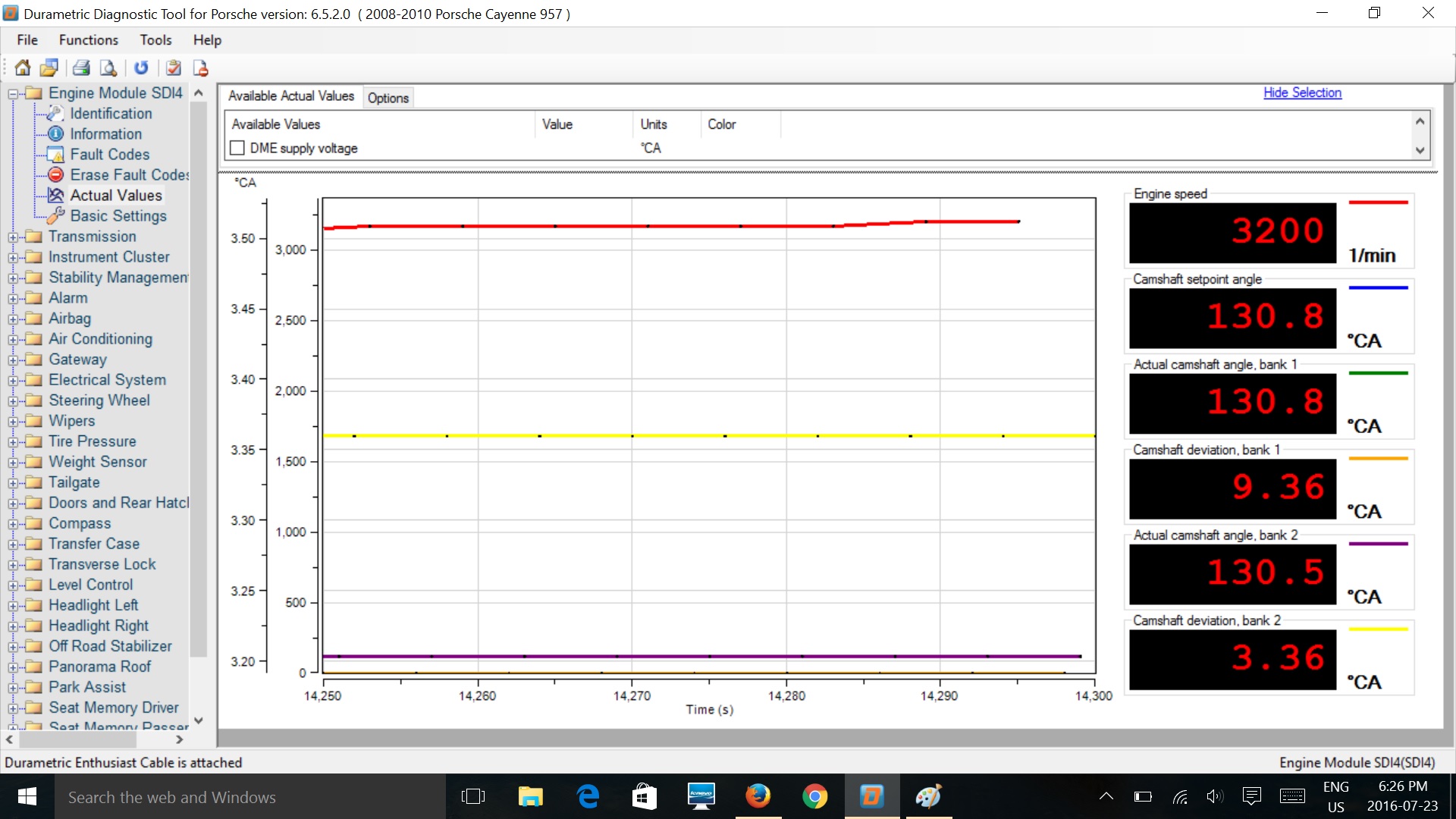

When idling rough, cylinder #3 misfires constantly. In a span of several seconds it has misfired in the double digits. HOWEVER, as soon as I drive, whether easy or hard acceleration, the misfires are gone. The misfires only return when nearing a stop (<10kmh) or when stopped at idle in park or drive. My fuel economy is still giving me about 500km out of a 90L fill up … so I think that’s typical.

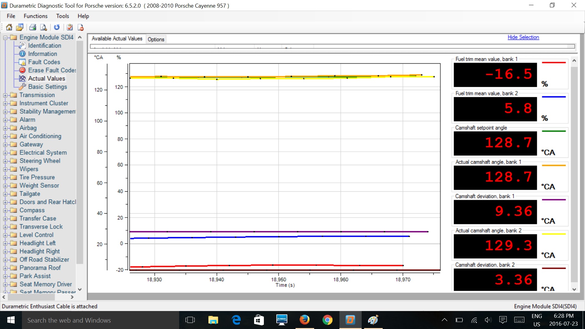

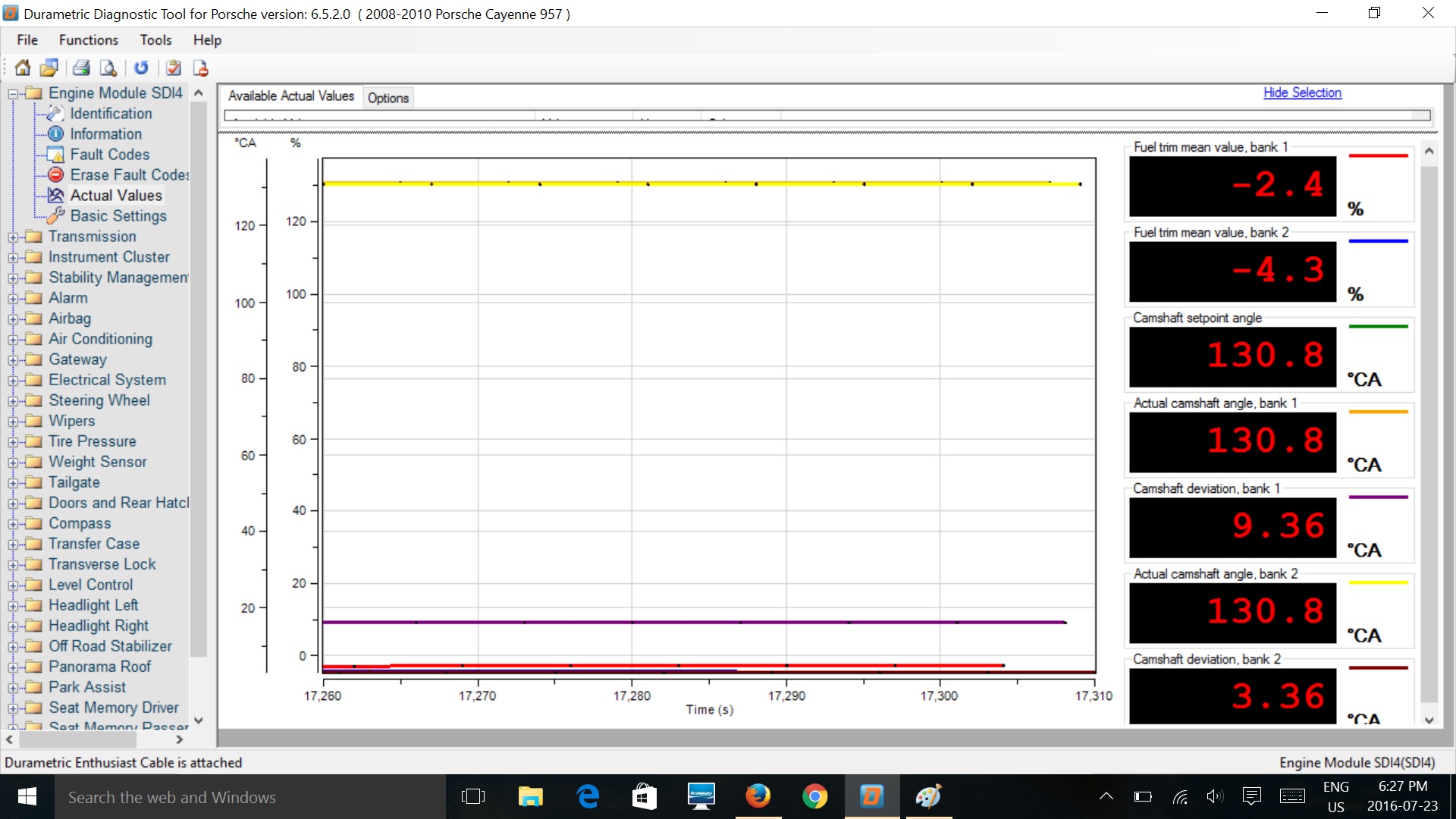

I attached a screen shot of when i drove with mafs disconnected. Fuel trims were off and misfire cyl 3 persisted only at idle but never when even slightly above idle. When i had to stop i held brake and just a 'hair' above idle so it wouldn't misfire. Also, with mafs disconnected durametric shows camshaft deviation fot both banks as '0'. Strange? Also, while driving my gear indicator on the instrument cluster just showed 'D' but no number for the gear i was in even when i selected manual mode. Stopped the vehicle, connected mafs, and presto ... gear display and camshaft deviation came back.
*** I keep reading +/- 6 degrees deviation is acceptable. Bank 1 is 9.3 degrees deviated and bank 2 is 3.2 degrees. If 9.3 degrees isn't enough to indicate a jumped timing tooth, is it enough for the cam/vane adjuster to have slipped???
