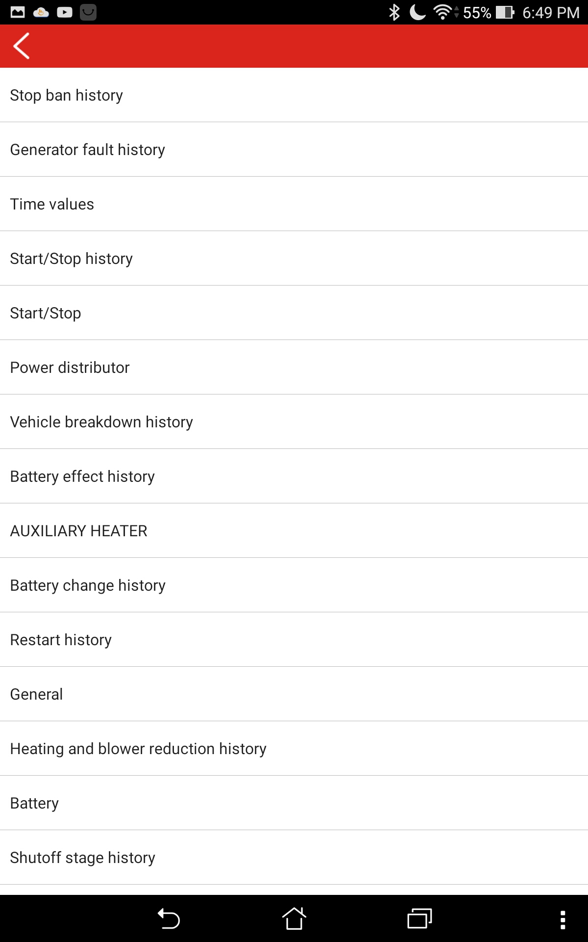

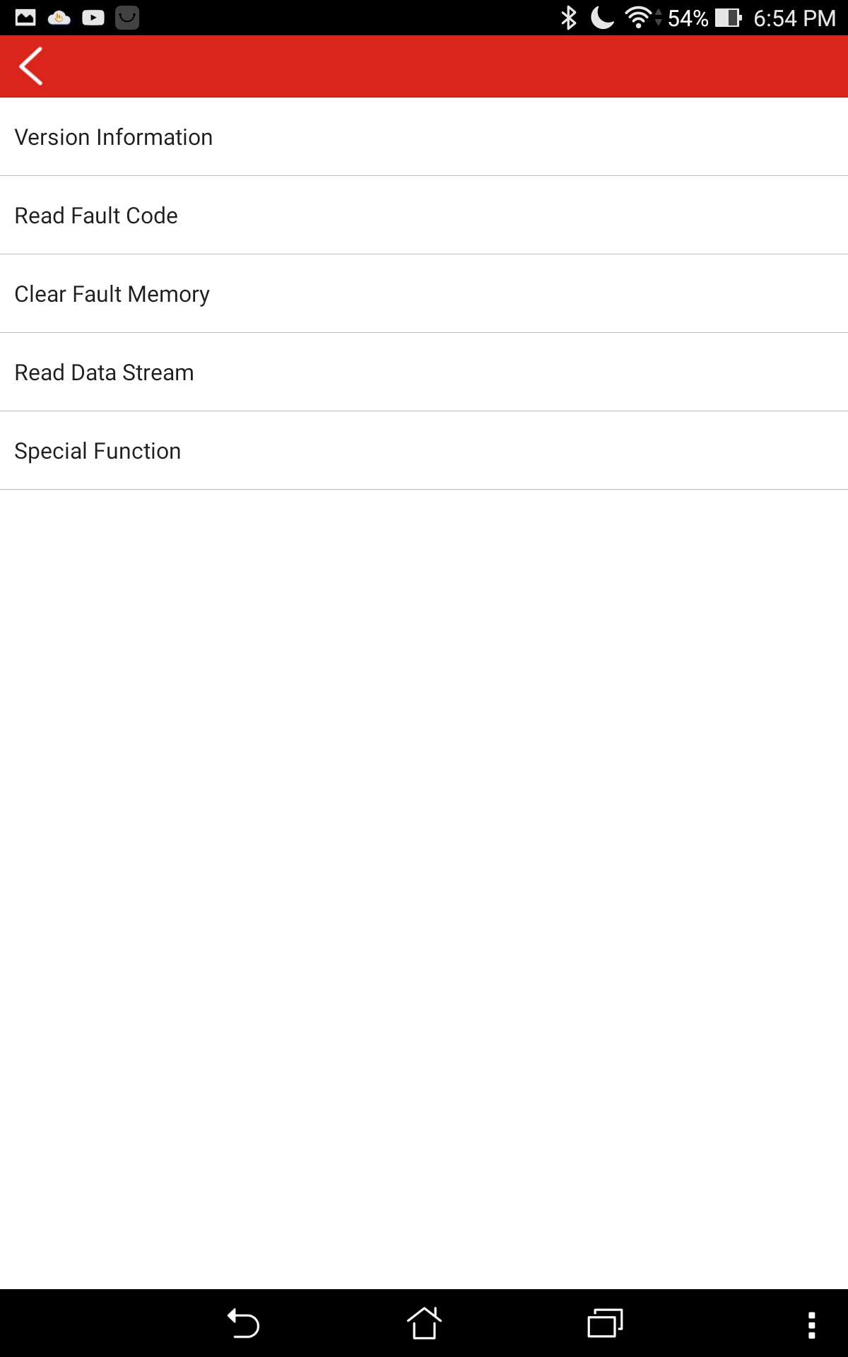

Version Information only listed a bunch of battery hardware sensor information. It was actually under "Read Data Stream"
I looked under "Battery change history" and "Battery"

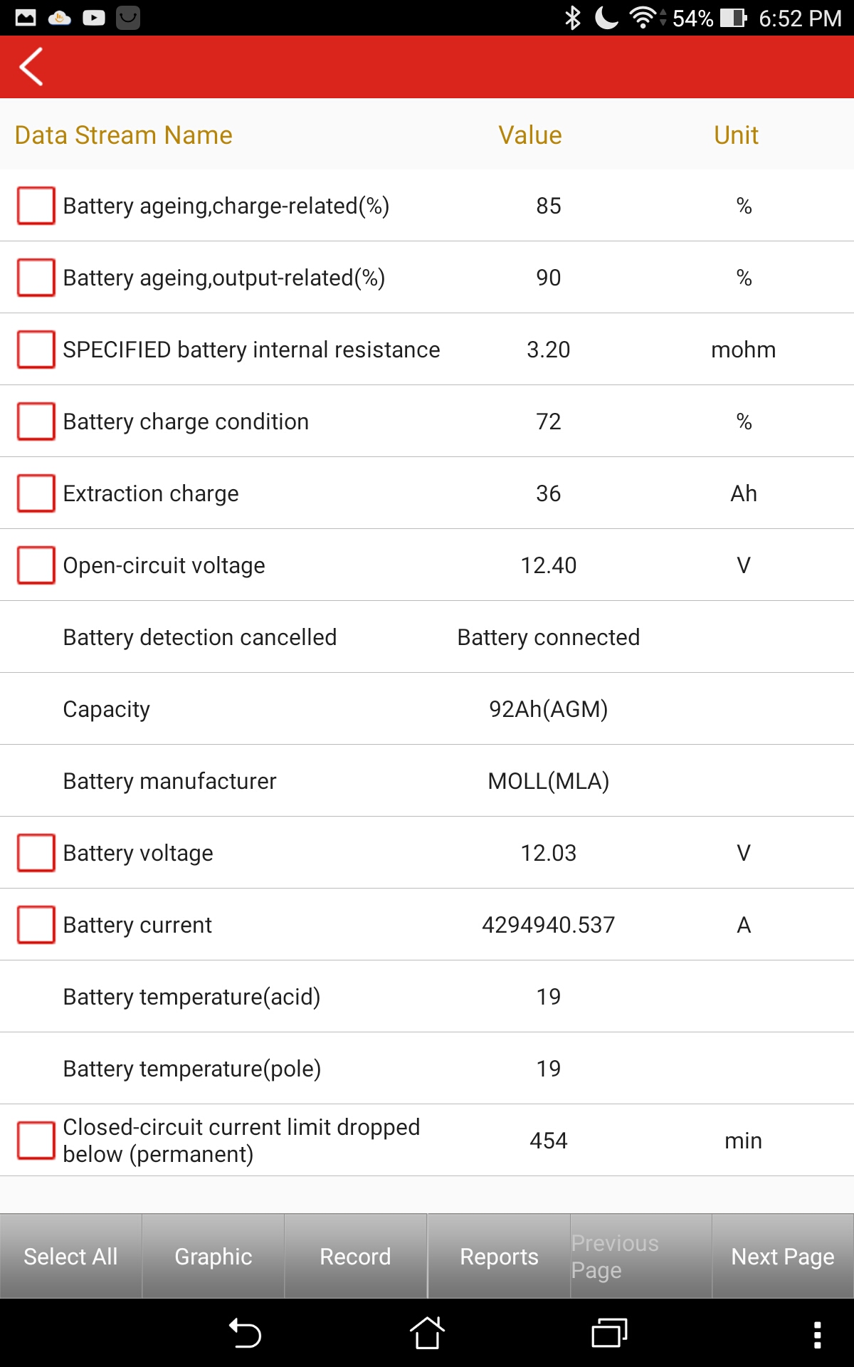

This is what's listed under "Battery." I think that's a bug for the amp calculation.

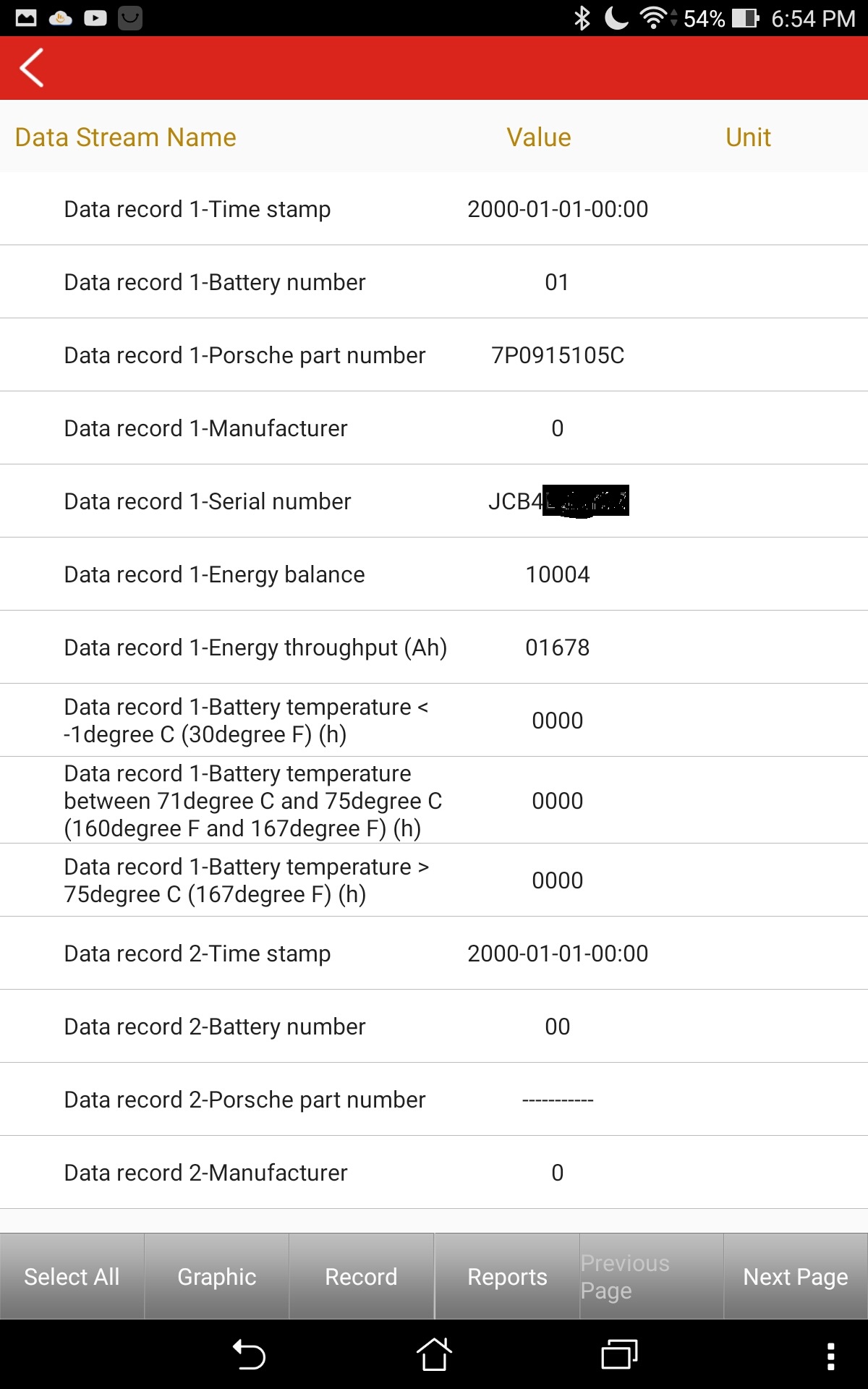

Listed under "Battery change history." I googled the part number and it came back as a VARTA. The manufacturer is listed as MOLL though. Anyone want to chime in about this?

The battery part number and serial are listed when I went to "read data stream" > "battery change history". As mentioned above, the part number I googled came back as a VARTA battery. Also note on the bottom of the screenshot, there is a bunch of fields for "data record 2" listing. I am guessing this is where it displays your newly installed battery after it is registered.

Found it - and it had identical info to what your data stream showed - except my sitting battery voltage was somewhat higher (12.40V) open circuit voltage 12.7V.. and some of the current readings are a bit different. The numbers vary a bit - but basically the same. Some of the numbers reflect my battery being newish. What is interesting is the type/date don't change, and looking through the numbers for Porsche PN, and battery SN, they are listed correctly for the battery I replaced - ie - the old one. So somehow at the factory they can set these values.
