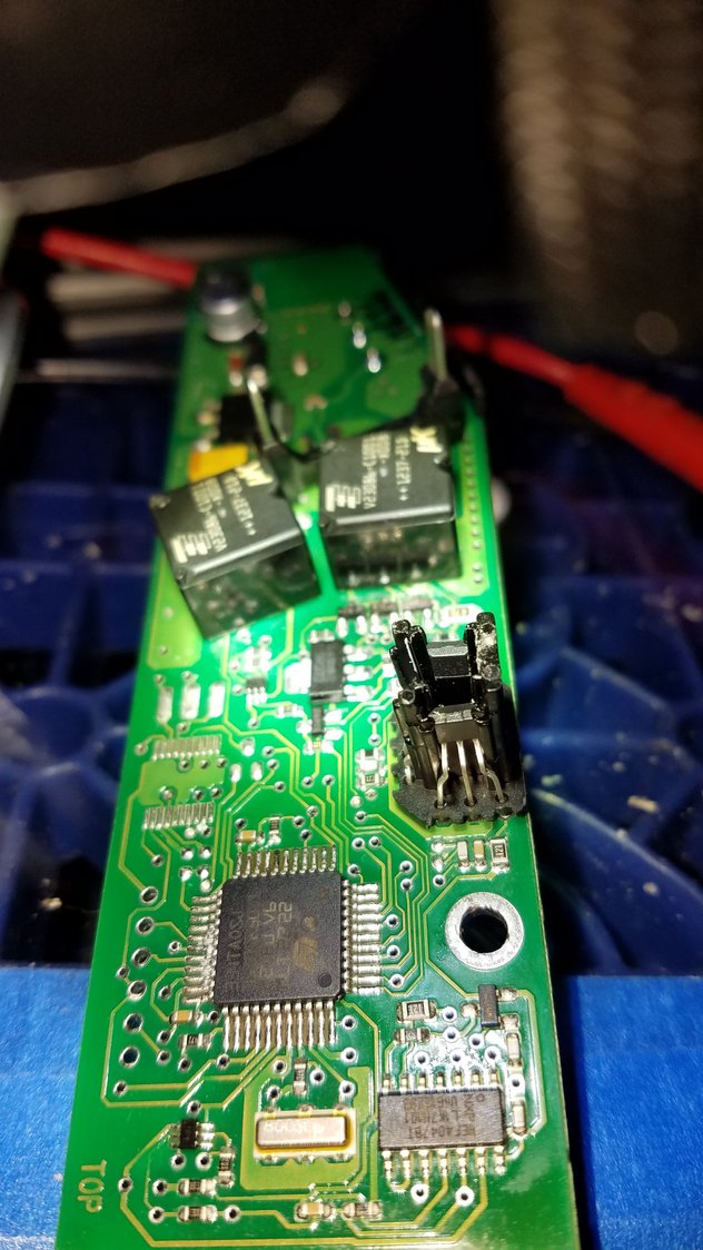

Its appears that its an electrical fault inside the steering column
there is a small board with lots of components and this is the problem, but you cant buy just that part it has to be a complete column which over here in Australia is $4,000 plus fitting and coding .

Three hall sensors on the lower right side in this picture.
White/clear plastic arm slides based on the lock position. Magnets (polar specific) trigger the start/stop via the on board hall sensors.
Bent/broken arm can affect magnet positions causing the motor to over or under extend or retract causing a 288 steering column fault.
On board relays can also fail. Reversing voltage isnsupplied thru CAN HI and CAN LOW. Voltage variances on these two wires along with an error sent via the data wire can trigger a fault.
