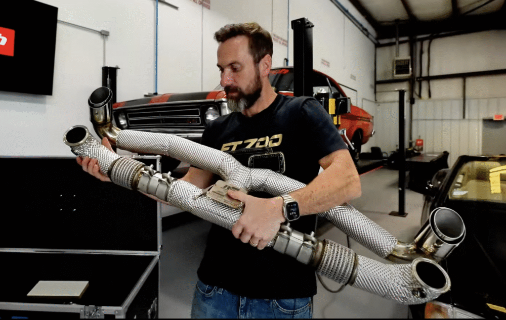

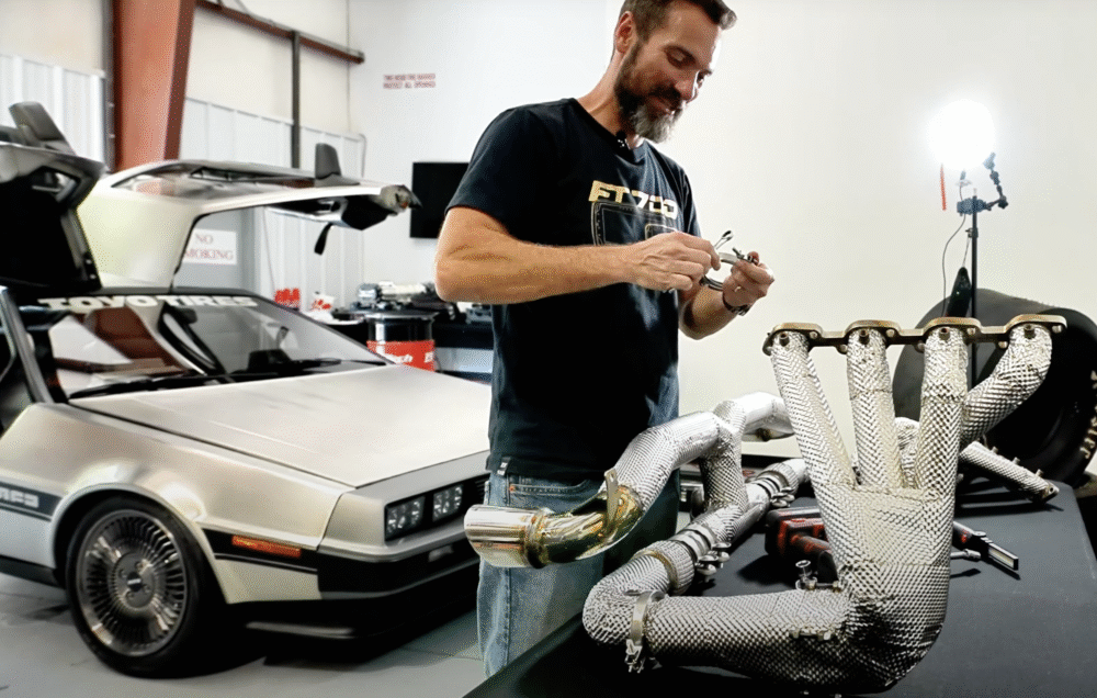

Having already built this F430 swapped DeLorean, FuelTechUSA decided to spice it up a little more. And they did so by letting it breathe even more. R Flow exhaust helped design the new pipes. Equal length headers merge into a 4-to-1 cone, and exhaust pulses proceed to a dual Y collector a bit farther back. The tips are nothing more than just some standard circular tips, but that’s all you really need in a setup like this.

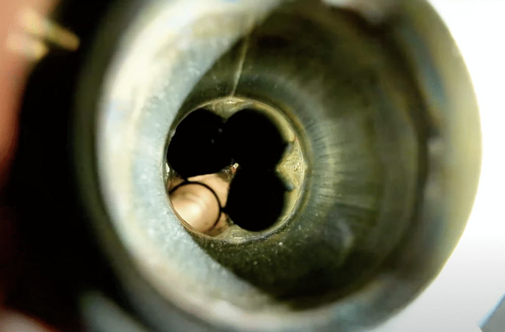

When you remember that engines are essentially wind instruments, it becomes easy to see why an engine of this caliber makes noises like this. With a flat plane crank, each exhaust pulse entering the 4-to-1 collector is evenly spaced out. This means there’s no rumble like you’d get from an American or German V8 with unequal pulses. Merge each side one more time with that Y collector, and you get the high revving exotica you’ve always wanted.

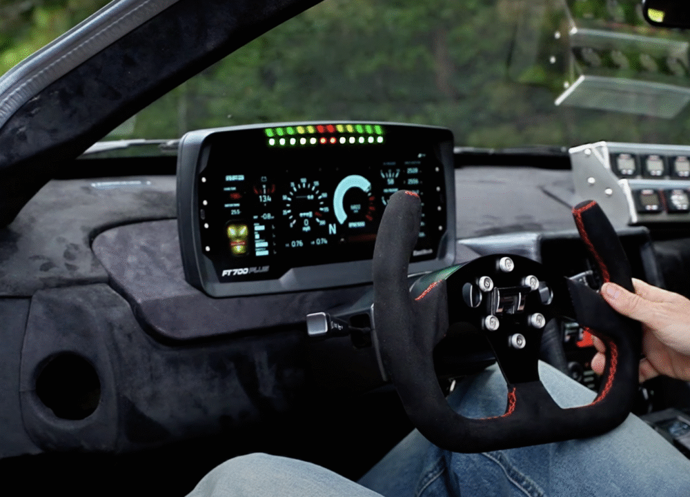

It looks a bit bizarre coming from the shape of a DeForean. But there’s no denying this car is crazy cool. And it is not just the engine or exhaust that has received special attention. The whole interior is new, too. A fully custom dash and gauge cluster takes the interior into the modern world. Gone is the original analog needle gauges and in its place is a giant screen to show all the car’s vitals.
