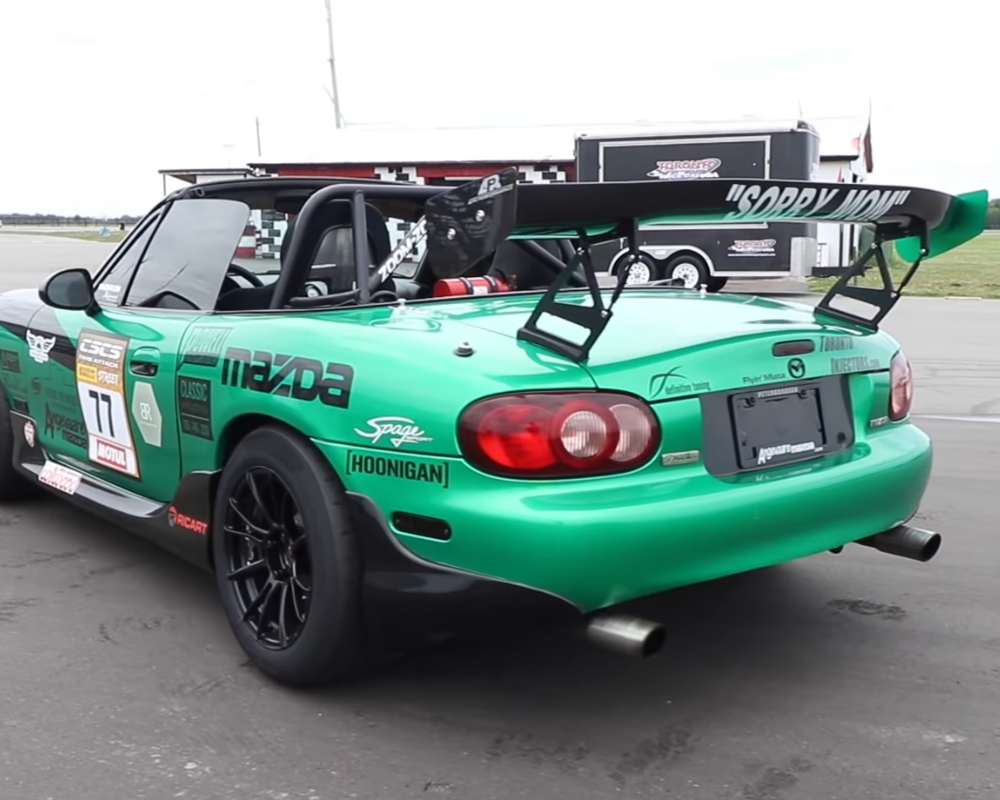

This very green Miata also used to be a supercharged 1.8L before swapping the LS1 5.7L V8 from a 2000 Camaro SS. This engine is mated to a T56 transmission and a Getrag rear-end. The car weighs a very respectable 2600 pounds wet. For the chassis, this Miata is running HSD 2-way coilovers, Willwood 6-piston front brakes and a Racing Beat 32mm front sway bar. A little front splitter and rear APR wing have also been added to balance out.

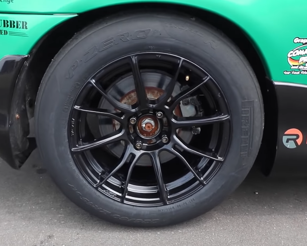

It is good to know that the car has gone unchanged for any other components since the V8 swap. However, this fact will be its downfall without a doubt. Once Pratte takes the Miata out on track, he notices a couple of things right away. While the LS1 screams with a vicious fury down the front straight and sounds great, the car has no balance. With a 225 section-width Pirelli P-Zero tire, the car is heavily lacking overall grip for the 400+ WHP this Miata makes. The suspension also feels a bit off, as if the springs rates can’t keep up with the added changes according to Pratte.
Eventually, Pratte ends up doing the whole track in 3rd gear because he doesn’t want to slam the little Miata into a wall. Although the Miata doesn’t necessarily have “bad” lap times, it is punching well below its weight due to the imbalance in the chassis and power level. Pratte suggests running a proper track day tire of at least 255 squared section width for a car this light and this overpowered. Not to mention the suspension setup and rear-end could use some work too. This just goes to show that building a fast car is more than just throwing a V8 in it!
