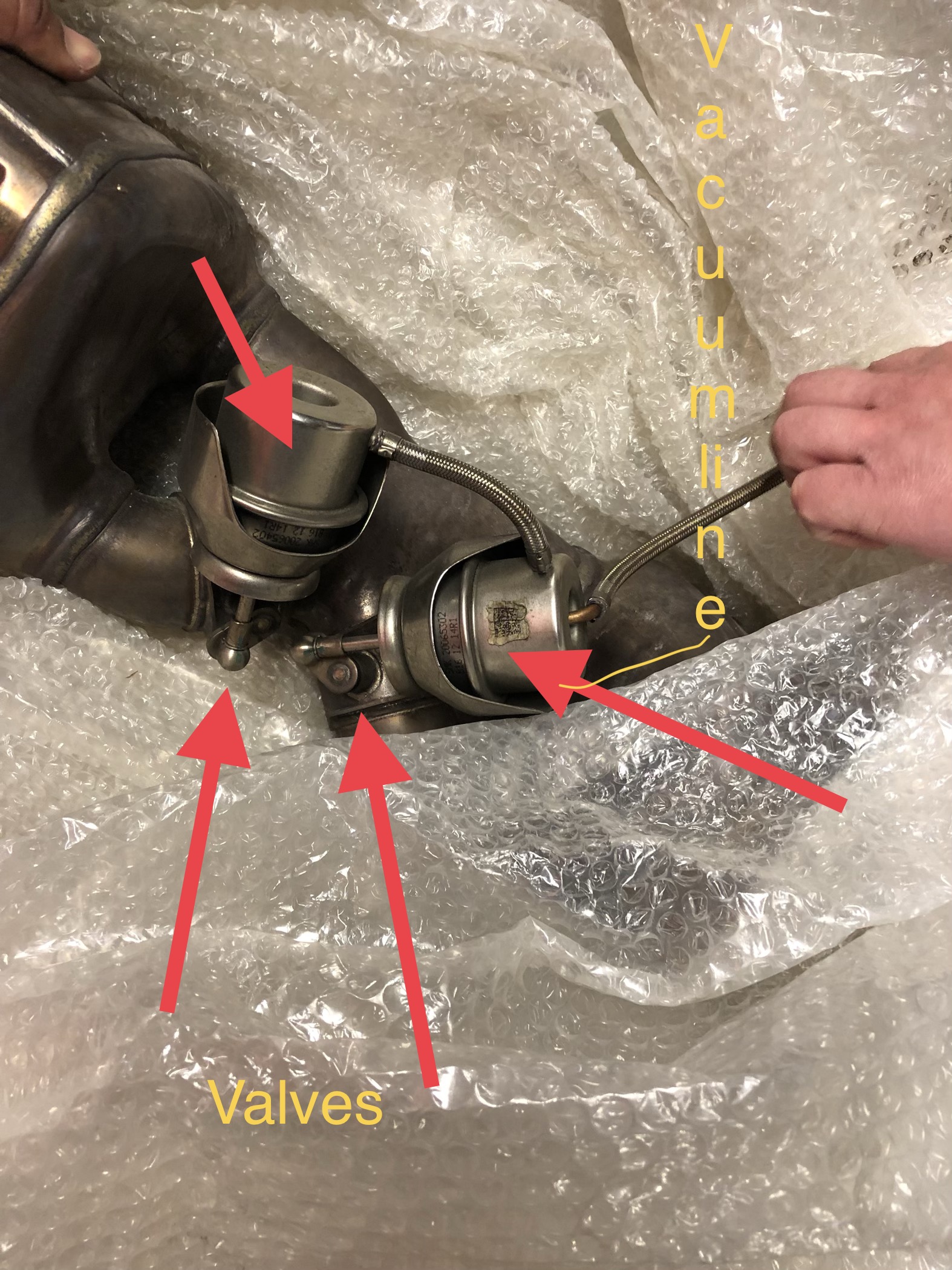

Hello guys,
Need some help with installation, Im planning on getting the PSE installed with no console switch, just the valves open all the time but need some help, I've been told by my dealer Tech that this can be done if we removed the valves and get wire to tight the valves open all the time, I'll be getting the old mufflers out and installing the new ones and no vacuum lines, just checking if someone did it like this before and how it was done or maybe it needs to be done differently
Thanks for any help.

Put a golf tee in the vacuum line, well that is what we did with my Corvette years ago.

Thank you, been doing a lot of research and some guys from the GT3 sub forum thats what they do, I'll tell the tech no to disable the valves and just to plug the vacuum line, see if that works
