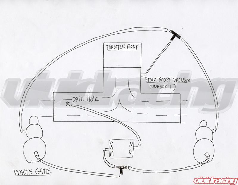

You hook up external Wgs differently to the greddy valve vs. internal WGs like on a K24/18g. I bet you guys followed the book instructions and screwed up.
SO if you have external WGs( tial) then COM and NO is correct. if you have internal WGs then you hook it up still the same way except the hook up the 3rd hole called NC to the DV line ... So that diagram is correct for external WGs... the lines form the COm to the WGs whould go to the top of the Tial and the side nipple should be hooked up to a pressure source like the compressor housing or near the Y pipe by the throttle body. YOU LEAVE THE NC PORT OPEN.
maybe soemthing else is wrong??? did you take out the plastic plug from the NC port? what did you guys do with the line coming from the DVs?
DID ANYONE PRESSURE TEST THE CAR? how much boost was it holding? IF not then the installers are NOT as professional as they appear to be.
I just did a basic k24/18g set up for a friend and I not only pressure tested from the turbos but I also checked the WGs to see if they open up at the same time. I installed the greddy as well... NO Problems on my end what so ever and I am no mechanic. I even ran a Y band on it to see the AFRs... all this is a MUST on turbo cars....

That picture Dan supplied is actually correct when it comes to external WGs....
Looks like you guys were runing in KILL MODE and the car made 2 bar or more...
IF that would happen I would immediately let off and coast back to the shop...
I think you guys hooked up the lines to the WGs wrong.... you hooked then up to the side of the WG instead of the top....
I also would like to know what happened to the Original DV line that was hooked up to the stock solenoid.
