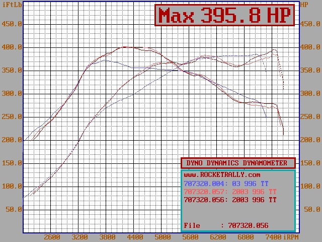

Old Oct 1, 2008 | 05:29 PM
  #43
kcphuah's Avatar
Posts: 490
From: Vancouver, BC Canada
Rep Power: 40
kcphuah is infamous around these partskcphuah is infamous around these parts
Well, I finally just got the email from the dyno place. Because I did a dyno from them in june, they were able to put the dyno result side by side on the same graph. The blue line shows my results from june and the pink and red shows result from last friday.

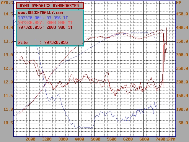

Another question that I was wondering is my AFR reading too high?
p.s. Scott, I will try to log in some more datas for you to review with these couple of days as soon as I am able to do so.
Is that the A/F on that lefthand dyno or is that a polygraph
Old Oct 1, 2008 | 07:14 PM
  #45
unvmy996's Avatar
Joined: Sep 2006
Posts: 7,481
Rep Power: 707
unvmy996 Is a GOD !unvmy996 Is a GOD !unvmy996 Is a GOD !unvmy996 Is a GOD !unvmy996 Is a GOD !unvmy996 Is a GOD !unvmy996 Is a GOD !unvmy996 Is a GOD !unvmy996 Is a GOD !unvmy996 Is a GOD !unvmy996 Is a GOD !
i was thinking the same thing lol looks liek its measuring earthquakes .
