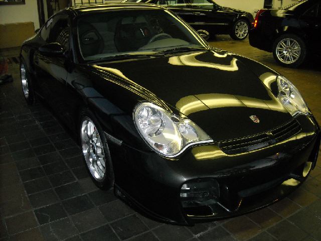

So the CONCLUSION here is simply don't buy the MISHA item as its too much hassle (in 2009 I installed a MISHA GT2 rear wing and its absolutely fine) and go for the Precision Porsche item, even though it costs more but fits better ?
Old Jan 18, 2010 | 01:58 PM
  #113
PrecisionPorsch's Avatar
Joined: Feb 2009
Posts: 2,286
From: USA
PrecisionPorsch Is a GOD !PrecisionPorsch Is a GOD !PrecisionPorsch Is a GOD !PrecisionPorsch Is a GOD !PrecisionPorsch Is a GOD !PrecisionPorsch Is a GOD !PrecisionPorsch Is a GOD !PrecisionPorsch Is a GOD !PrecisionPorsch Is a GOD !PrecisionPorsch Is a GOD !PrecisionPorsch Is a GOD !
Richard (btw, this is M32, the OP)
Please keep in mind that I made this thread way before I got involved with Precision Porsche. In fact, I didn't buy precision porsche TA front b/c it was more expensive.
Here's my $0.02 since I've installed both the MISHA and the PP front personally. I know I might get flamed for this but I'll try to be as unbiased as possible.
MISHA VS PP TA front comparison
Top air intake: Precision Porsche.... hands down, the fit and finish is way better. The gaps between the slats on the MISHA was horrible
Radiator ducts: Precision Porsche... b.c the PP radiator ducts DO NOT have the three slats in them like the MISHA ones (which was the main problem). If the MISHA did not have slats, it would have been a tie
Bumper cover: Tie... both are a very tight fit but once you get the hang of how to install, it'll be ok.
Lips: Precision Porsche. The PP bumper comes with the lower lip already mounted on the bumper and the lip is a little thicker
Radiator splitters: Precision Porsche... MISHA's bumper does not offer that option
Price: MISHA...but once again, the MISHA one does not include the radiator splitters so it's not a true apples to apples comparison.
Verdict: if you like to DIY and know how to work on FG or have a body shop connection, MISHA's is a good buy... but keep in mind that you WILL spend a lot of extra hours cleaning up the peices.
Just my $0.02
Edwin
