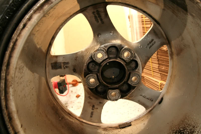

Searching the for sale posts for photos turns up the following pics. I'm not sure if there's anything distinctive in these telling one way or the other?...
This one claimed to be hollow spoke from an '02 996TT:

Mine are oem, they have the width left of the valve stem and offset right; raised on the front of the wheel.
