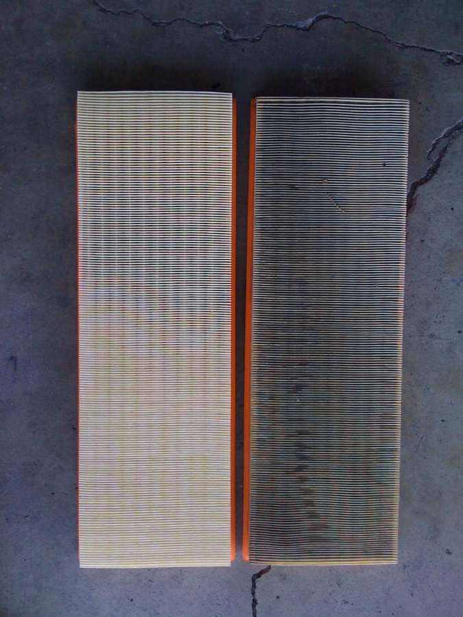

After purchasing my 996 TT at 56k miles, I decided to change the cabin and air filters. Car was running a little bit sluggish and felt like it was missing some power at the top end. Changed out my air filter and wow what a difference it made, drives so much smoother throughout the power band. The cabin filter was pretty much black from all the dust and crap it has collected. The filters were also super easy, definitely a DIY for anyone. The cabin air filter took about 2 min tops and the air filter took about 30 min cause I couldn't get the damn airbox back on the intake hose.
Here are some before and after pics of my filters.

Etch, the cabin filter is a snap. Here's the diy instructions. You will have no problem doing this haha, it's just one torx screw and you have access to the filter.
http://www.renntech.org/forums/index.php?showtopic=7058
Its on renntech and you will have to register in order to view it. It's a great site though and definitely worth your time. I got my filter at pelican parts.

nope got both filters at pelican parts, I think the brands were Mann for the cabin filter and Mahle for the air filter...under $50 for both filters and they were shipped the next day I ordered it. Just a fyi, the filters I took out turned out to be the same brands I put in.

I was wondering if mine used the charcoal filter as well, but pelican parts said the charcoal filter is only for cars with the m571 option. I checked my options list and I didnt have that option so I just went with the paper one.
