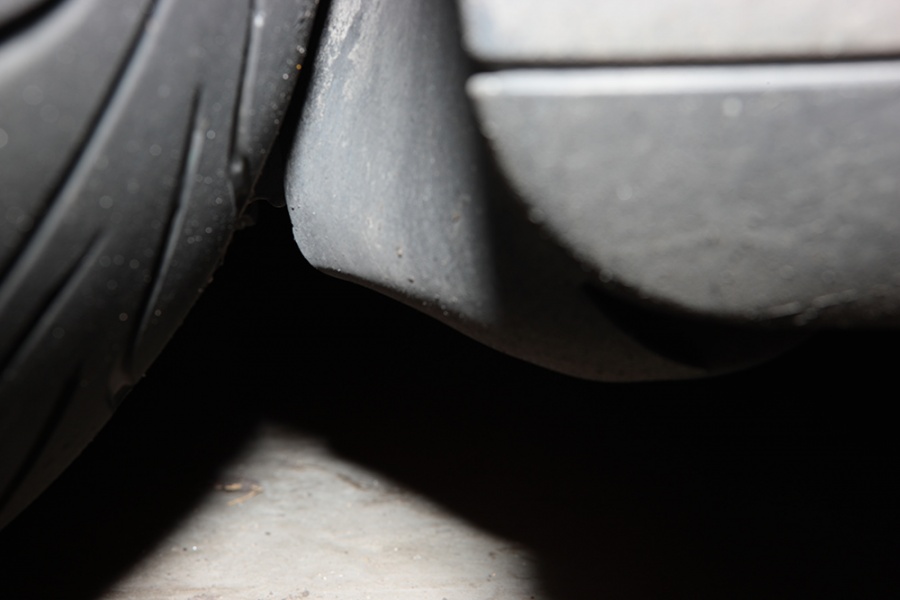

Originally Posted by flash68
Do you happen to have any pics you can post of your IC hoses and the clearance betw the rear of your tires and the flaps/hoses/ICs? thanks man
Pic is not very good as it was very difficult to shoot well in the dark. But there really is plenty of clearance there.
Thanks Mike, but yes I can tell you clearly have more space there. I wonder why 911GT700 has the same stuff but similar issues as mine?
Cant imagine why? Are your wheels 18s or 19s?
