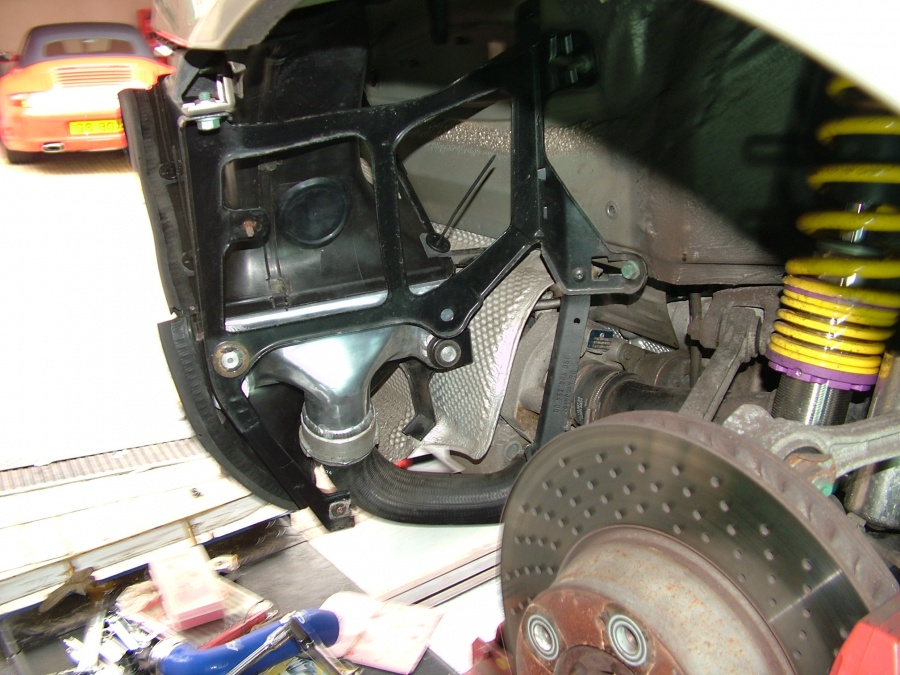

I was so stoked today to get my new OZ wheels and Nitto NT01s installed and start ripping around...
but because of the protruding hose/clamp/hose/clamp mess connecting to my Proto ICs, the slightly taller tires made too much contact with the plastic/hoses/clamps on both sides. (pic below of passenger side)
So I guess we are gonna look at doing a more direct hard pipe for the extra clearance required even though I was waiting to do a fully permanent solution at some point, but maybe that time is now.
I have a modifed crazy clamped Samco boost hose set up currently due to the oversized Proto ICs. I think they are the 3.5" ICs.
You think I should just get some hard pipe custom fitted from the ICs to the turbos where the clearance issue is?

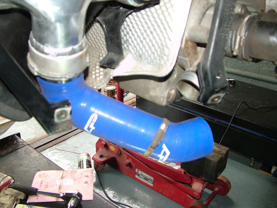

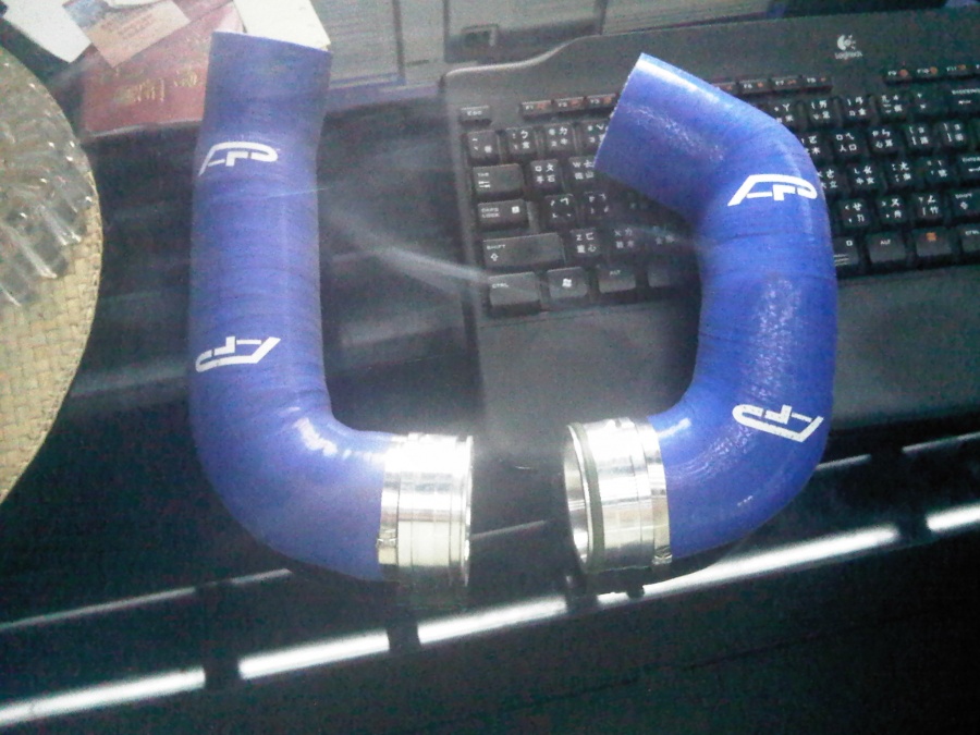

bummer... attached some photos for a visual of spacing. Depending where the rubbing is, as long as it's not rubbing near the IC inlet or the turbo outlet coupling side, could bring the pipe back towards rear of car and do like a U turn. Prob can fab a custom mud guard if that doesn't clear either. Left and right side hose routes are slightly different.
Thanks for posting those pics. I wonder if your AP hoses are are the same path of routing and shape as my Samco hoses, even though my Samco hoses are kind of modified and quadruple clamped or something. Are those AP ICs as well?

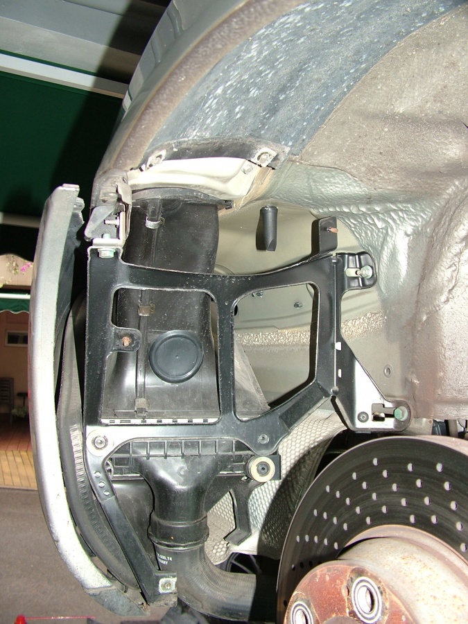

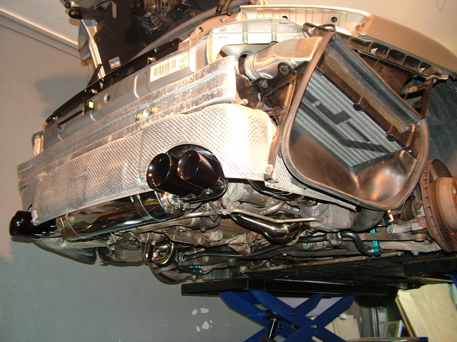

Here's some more pics I just snapped. Are yours (or anyone else's?) protruding this much?

holy crap that last pic is super clear; love the resolution and depth of field ... way off topic but are you using a macro lens on an slr or just a point and shoot camera?
