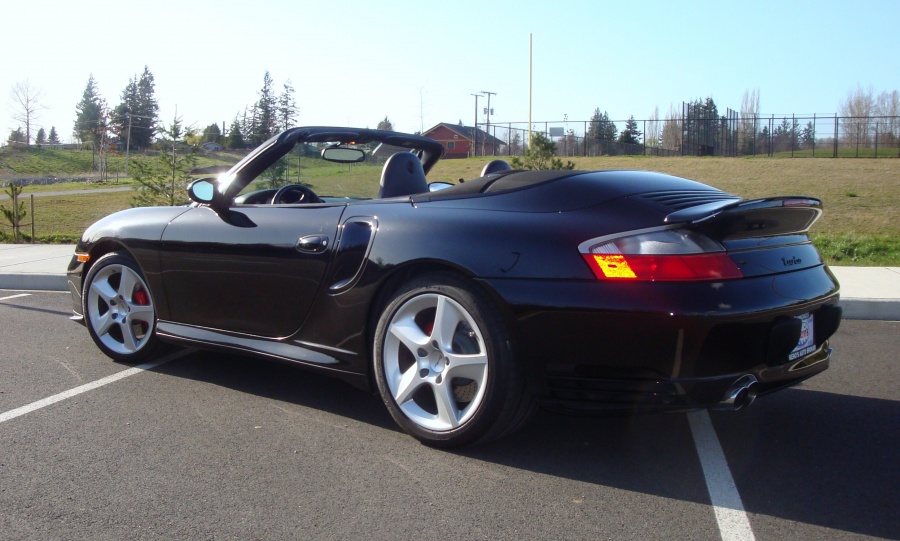

Here is a picture of my car with 17mm spacers on the rear.
It was a factory option.
XRN F DISTANZSCHEIBEN 17 MM, 2 ST. HA

^ I believe sport techno wheels require spacers on a wide body, not to make them sit more flush.
