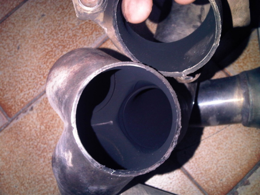

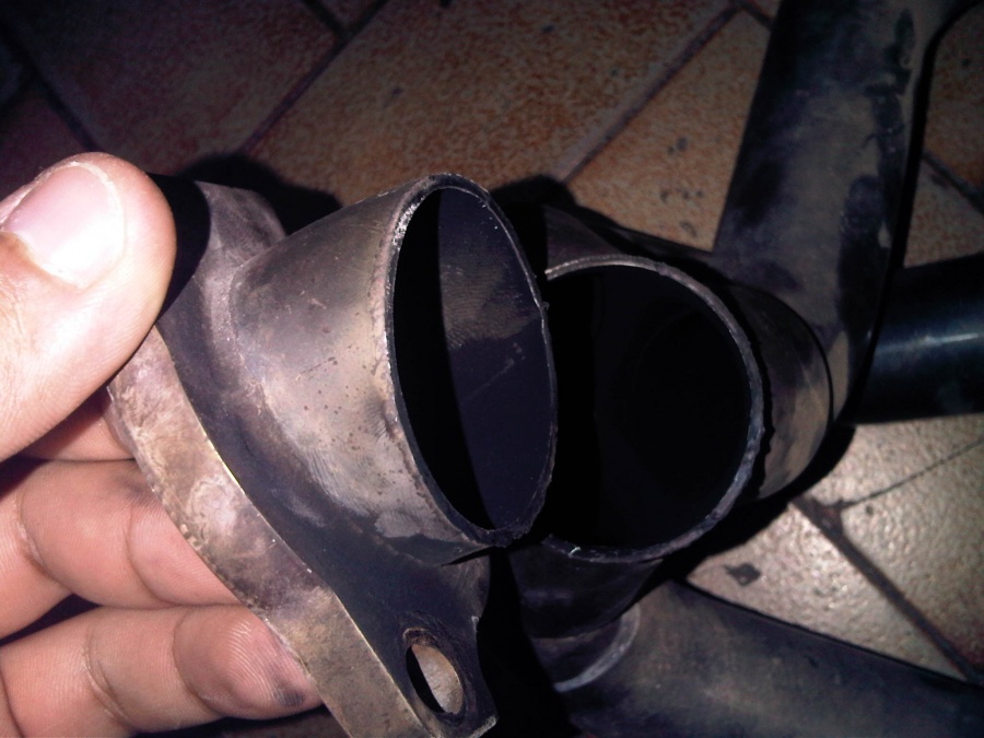

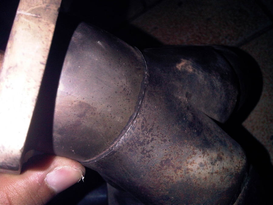

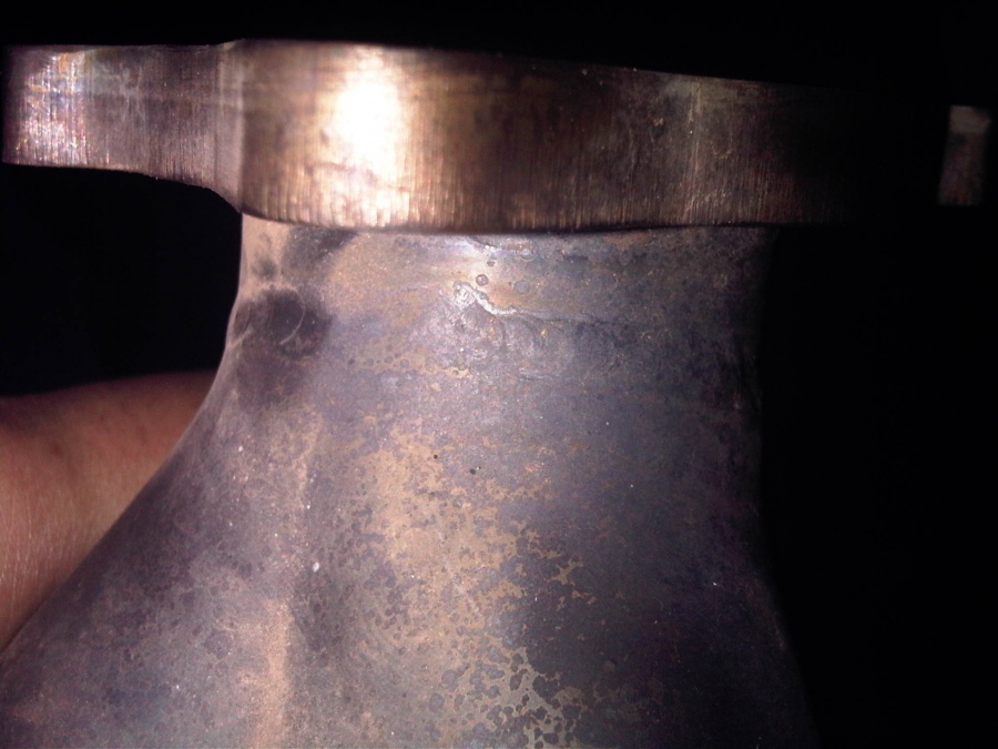

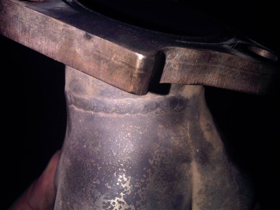

I brought more pics .. It may help to know ..

What do u think ?? .. welding or material ?

The material is too thin and the welds do not have enough penetration.

I don't believe anyone should be jumping to conclusions. A weld defect or the use of the wrong filler material can be easily determined.

Metal fatigue, yes over the specific metals usage and time. A proper full penetration weld made with the proper filler metal is stronger than the parent metal. Application also comes into play, however the designer/manufacturer must provide installation instructions for the specific application.
If the weld fractured my guess without looking at the part is defective weld or improper filler metal being utilized. I use to hold through my company ASME A,R,S,U and PP Code stamps so this isn't really something new.

welding not deep enough.
