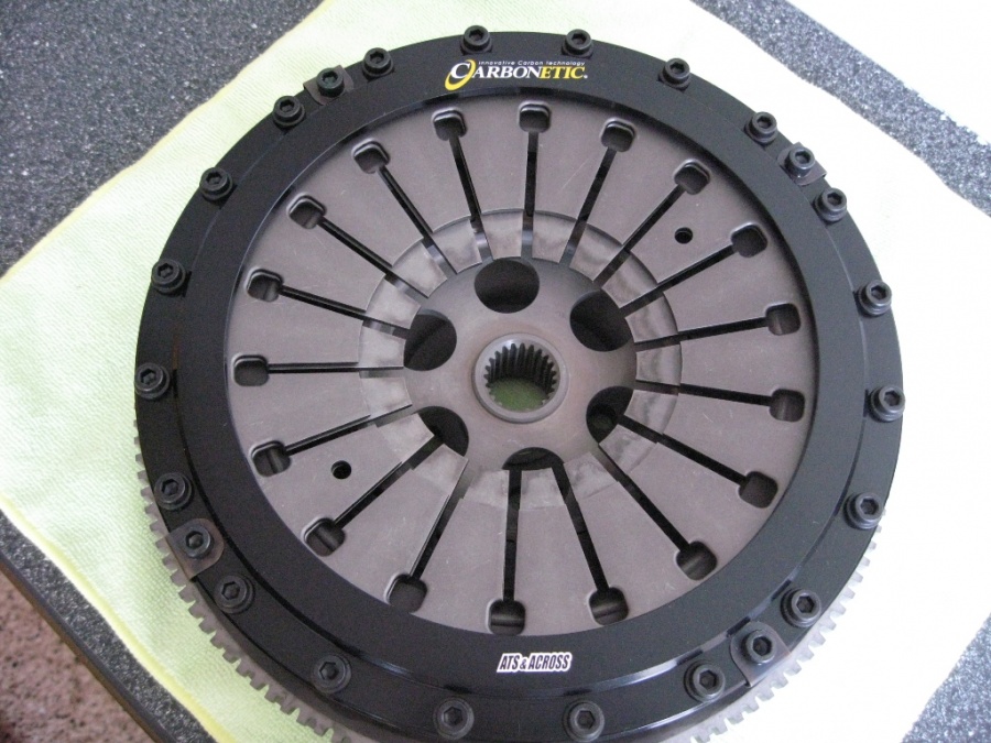

I have the Carbonetics Triple Disk Clutch and LWFW.
I have the 9 inch clutch plate and 11 inch clutch setup. The disk is a composit of Carbon, Silicon, Aluminum, Bronz and Titanium. The LWFW ia Aluminum.
LWFW weights 11.5 lbs
Clutch weights 12.3 lbs
Simply an awesome clutch and will hold 800+HP, 1000 TQ. My car makes about 590HP to the crank.
It takes 800+ miles to break in.
It does not stop the tranny gears from making noise at idle.
Remember, the LWFW does not make any noise it comes from the LWFW's inability to keep the tranny grears from moving around at idle so you hear a rattle noise. I changes the tranny oil when I changes the clutch but this will not help. No way to get around this. Some make more noise that others and depends upon the weight of the LWFW. I like myne to be on the light side and get the maximun effect of having a LWFW = quick engine revs throughout the entire rev range.
