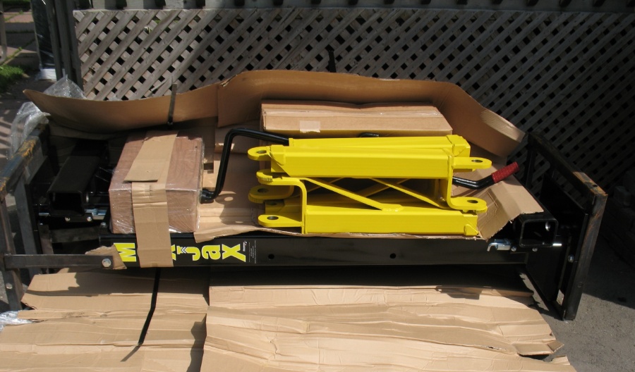

Just receive a Maxjax today! Will install next Saturday due to new epoxy on the floor.... I was surprise, the bolts are all metric and some stickers on it are in french !

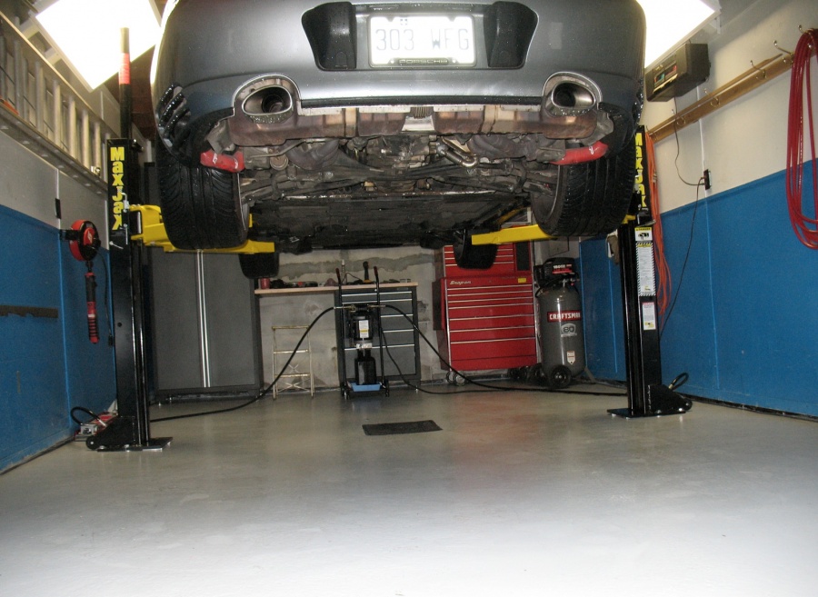

Sorry if I am answering before the OP but in my case I simply love it! The underside of the car is completely free to work on it. I had to remove the engine last spring and this tool was simply perfect! At the beginning I had problem with the quick release fittings but Danmar was aware of this problem and they replace it immediately. Very good after sale service. I got a very small garage and very limited in space. So the proper positioning of the posts was critical because of course you would like to work on different type of cars...

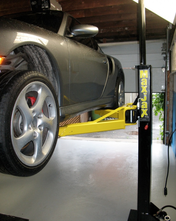

Agree about the safety! It does have two positions. One full up that gives you 45 inches under the car to work on. And the other position is about 30 inches from the ground. In that position you got the wheels in front of you to do the brake job per example.
I always leave a bit of hydraulic pressure when I rest the car on the pins.

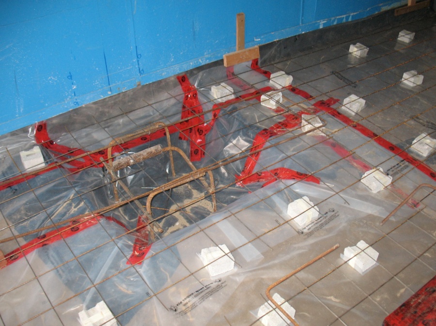

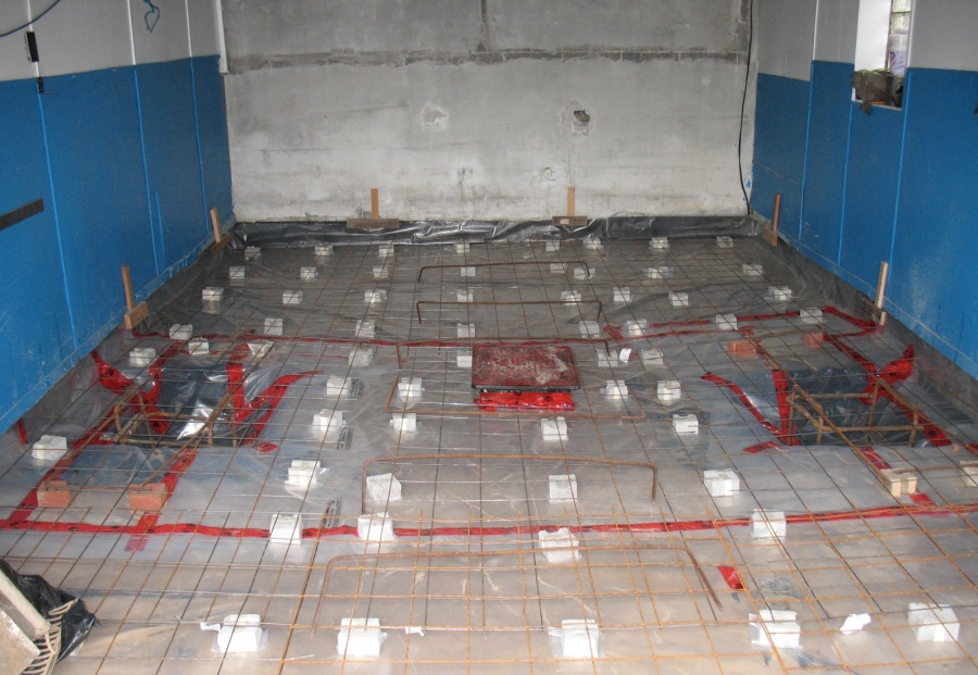

Talking about safety, the proper installation of the posts is something you have to be careful with. You need a good cement floor about 4 inches thick with 4500 psi strength of concrete. Of course I over done it with two pits, where the post will be installed, over 16 inches deep and reinforce with metal bars and the cement used was 5000 psi in strength.
