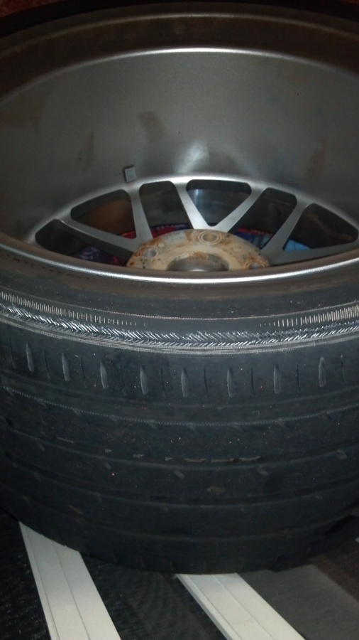

Well I had my worn out rear tires go flat today, so I need to get 2 new rears or 4 new tires... tires on my car now are the yokohama advan sport.. fronts 235/35/19 and rears 315/25/19... well they do not make the rears anymore... and of course my fronts are like new.. so what to do...? was thinking getting all new tires, trying out the NITTO INVO's.. I have champion wheels on my car.. not sure the width.. but is there another tire size combo that works on our cars? I dont want to screw up the awd system with wrong tire heights.. thank you... will post a photo of my worn tire.. steel coming thru amazing how these cars eat rear tires..

rear tire photo

Mine look just like that too!
I've actually worn through the steel thread in places
Out of interest, how much tread do you have on the outer edge?

Nitto Invo's are great tires on my second set myself great wear and traction. Also check on your allignment my rear tires wore like that in the insides found out my allignment was off even though car tracked perfect. I run 19x8.5 Fronts Tires Nitto Invo Tires 235/35/19 Fronts 19x12 Inch in the Rears (18mm Spacers) Tires Nitto Invo Tires 315/25/19 Rears.

ant_8u outer edge looks almost new My car is pretty low... so I guess its hard to get the alignment correct.. guess dog bones rear suspension pieces are needed to stop the wear...

I was in the same boat with a pair of PS2's, 235/35/19's up front and 315/25/19's in the rear with 2 degrees of negative camber and running PSS9's at ROW height. Well the rears lasted about 4000 miles with major cord showing on the inside and the outer looking almost brand new. So bought another set of 315's and went through the same thing. So I called my mechanic and asked him to try to get the camber as close to zero as possible and I went with 295/30/19's. Tires lasted a ton longer on the rear, but did notice the car felt slightly more unstable above 140. I do like the 295's in the rear since it gave the car a little more "cushion" and the ride smoothed out some. Now I did try some Pirelli PZeros and loved them at first, but they got out of balance quick and I had to keep getting them re balanced.
