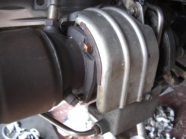

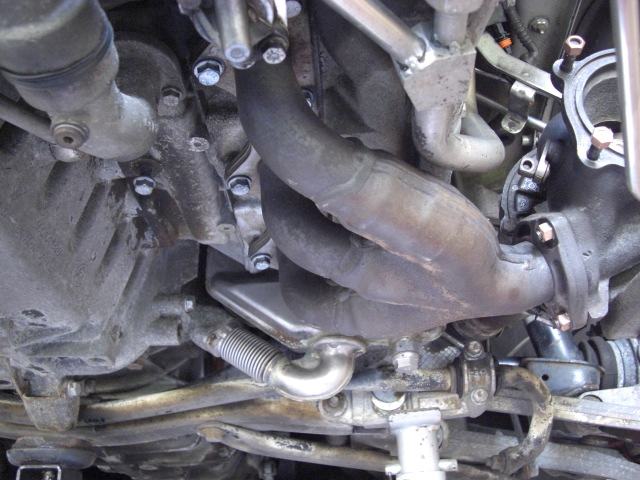

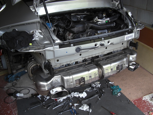

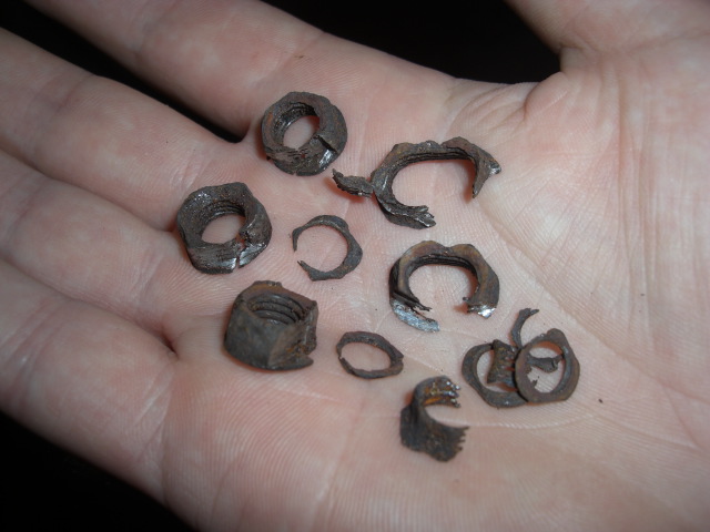

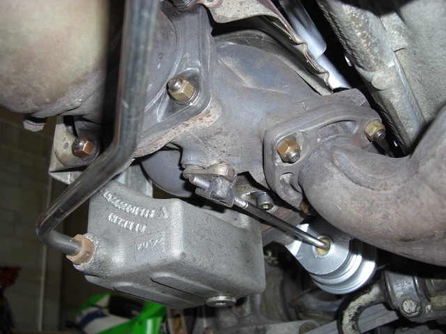

I've recently replaced all my nuts and bolts,but I took the turbos off completely.
The method I used to get the nuts off was to grind one side flat and then crack them with a chisel, they came off amazingly easy using this method and it also didn't leave any metal behind in the threads, hopefully if the pic works you should see what I mean. A couple of mine were almost non existant too but they still came off using this method. If yours are too far gone you might, like you say, have to take the manifolds off. Running a die nut up the studs is the method to use to get the remains of the nut out of the thread.
As the nuts were so corroded I expected the studs to be in a mess as well but surprisingly they were perfect no corrosion what so ever.
Also instead of paying £3.90 for each nut from Porsche I got them from Audi for 30p , they are proper exhaust nuts from a turbo Audi so should be fine!
I've attached some other pics I took
