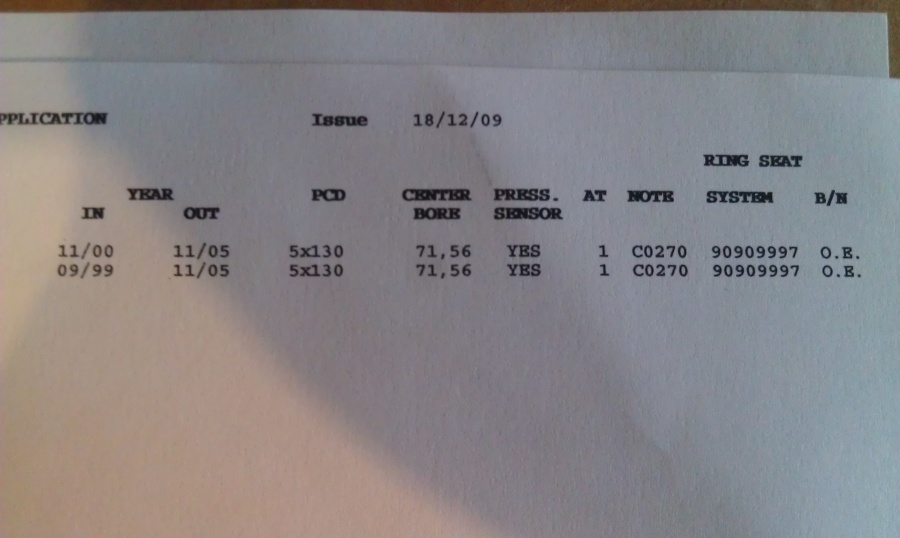

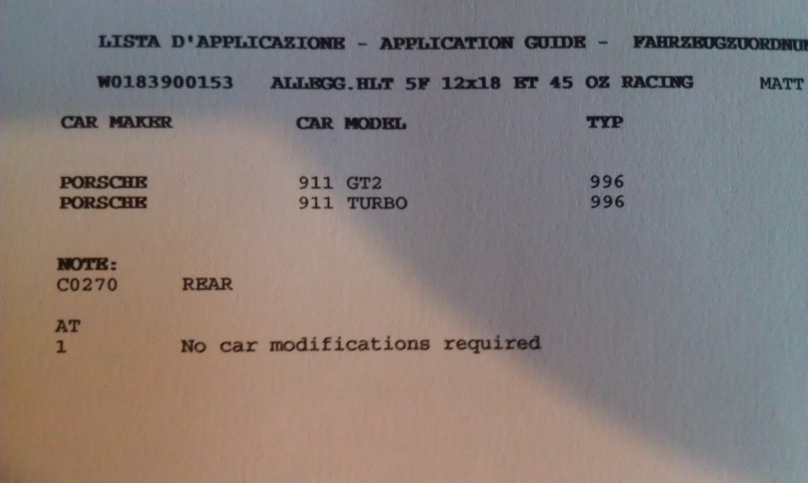

THEY FIT !!!
Just installed the rears as the fronts are back ordered. They fit with no problems at all. The wheels are the GT2 size and the tires are 315/18/R88s.
I had plenty of room on the inside, even with larger intercoolers and hoses.
I was prepared to roll the fenders but did not have to. I took the car for a test ride down some very rough roads with no rubbing at all.
The paper work from OZ even says they will fit the turbo with no mods.
