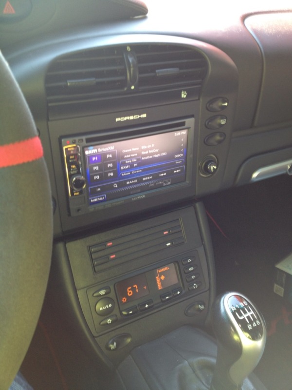

Not sure if its what you're looking for, but here's mine...
it's a kenwood ddx419 i believe.

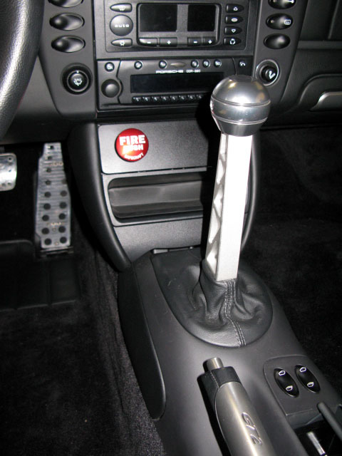

I thought about doing this, but my car is so loud I seriously doubt talking on the phone is possible.
Here is what I replaced my CD player with:

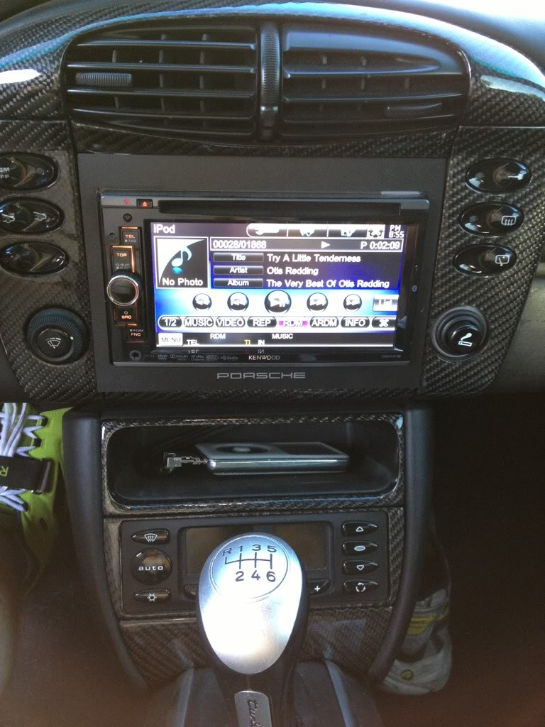

crappy pic, but here's my excelon kenwood with a console delete underneath:

Where did you get your double din kit? The cover plate is sharp.

Bought the kit off ebay, I relocated the climate controls.
http://www.ebay.com/itm/99-01-PORSCH...item3375a80f35

That's the kit I bought; but your trim plate looks different from mine. My trim plate has the Porsche logo on the bottom of the radio whereas yours is on the top.
Interesting.

I have the same one but I set it so the illumination to match the Porsche amber color pretty well

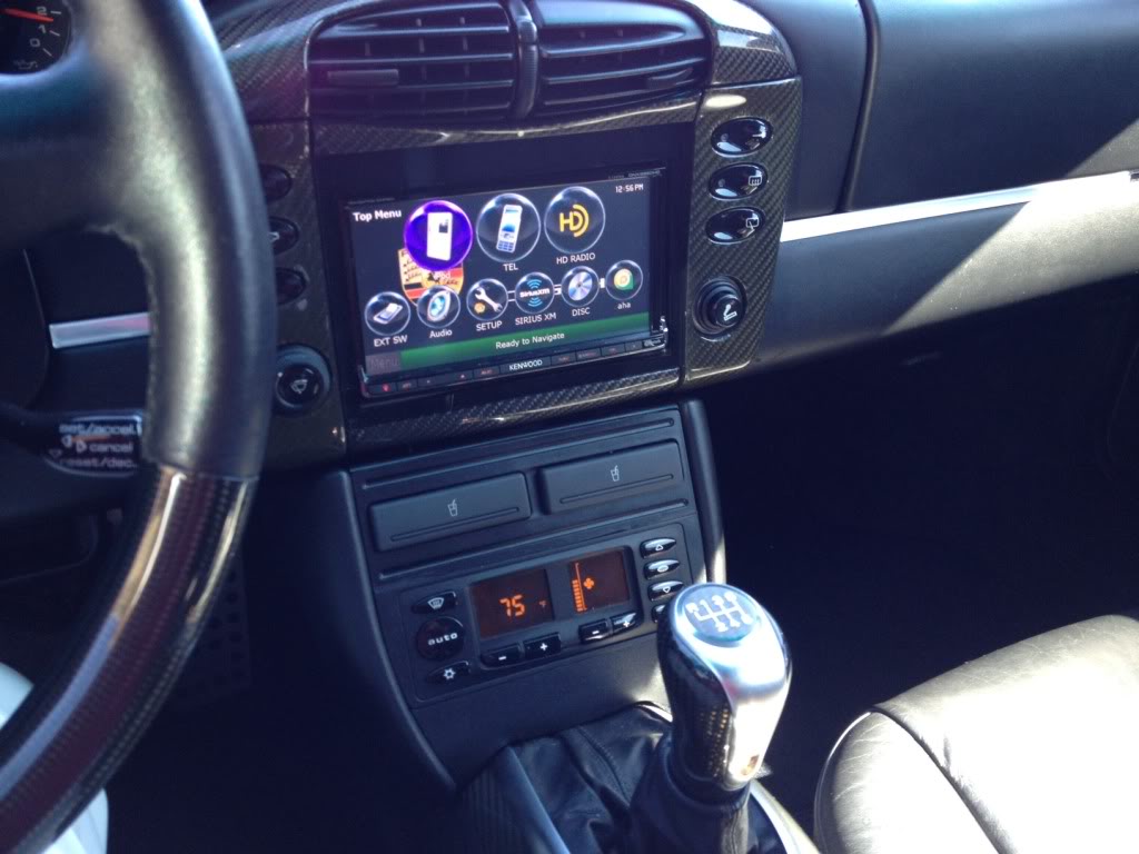

Here's my setup. It's a Kenwood DNX9990HD head unit with factory cup holders mounted in the lower console.
I used the cage that came with the headunit, bought the wiring harness and antenna adapter on ebay and made the face plate.
The faceplate is a 1/4" thick piece of plexiglass with the back side painted black. This give the faceplate a deep high gloss finish similar to the head unit (hard to tell in the picture).
The cup holders are not complete as I have a new cup holder surround to trim. My Dremel battery went dead when trimming the cup holder surround and I tried something else. Bad idea, as I basically "hacked up" the cup holder surround.
FYI getting the cup holder to work like this is a royal PITA. The stock cup holder doesn't even come close to fitting, so it's definitely a custom project. You will need to significantly cut down the cup holder chassis, its surround and also trim the opening in the console slightly.
When that's complete you will need to build a frame to mount the cup holder chassis to and attach it to the console. After this is complete, you will have a functional cup holder, but not a great cup holder. It's not only shallow, but now at an angle. Basically you undertake the cup holder project at your own risk.
Later, Steve

I noticed that too...mine was definitely from that seller though. I've had mine for over a year though, maybe he's changed it since then.
