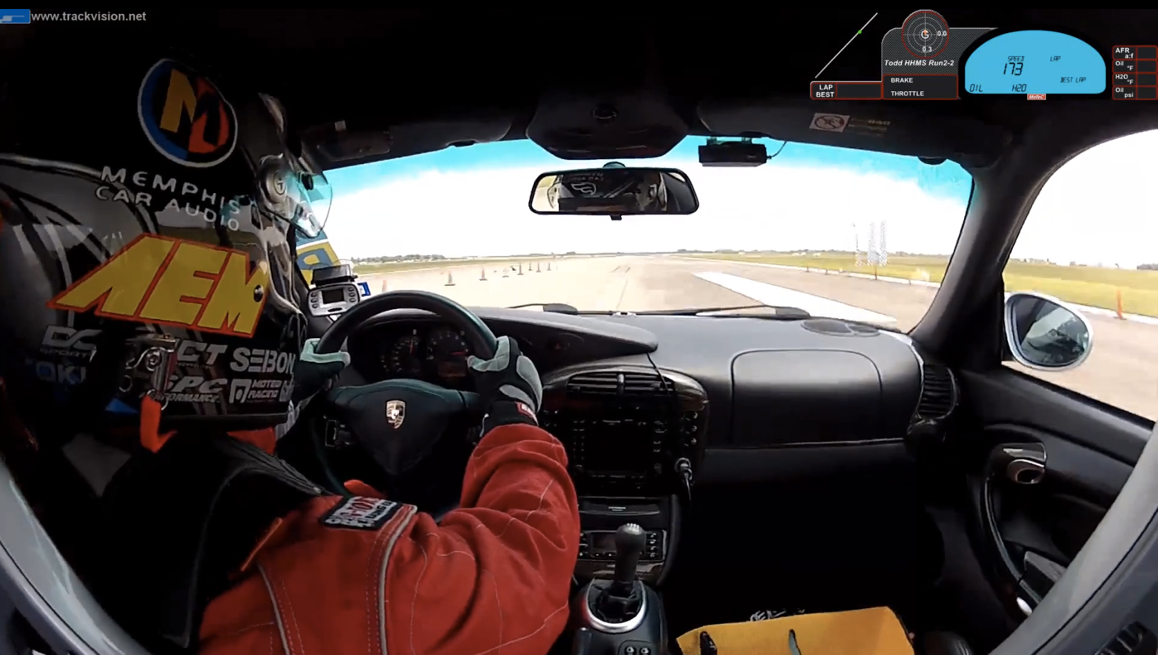

Originally Posted by z06801
hey while you are doing the math what is the MPH at 7000 rpms in 5th?
This pic shows I'm at 173mph around 7000rpm in 5th gear. Stock tranny on 315/35/18 tires
