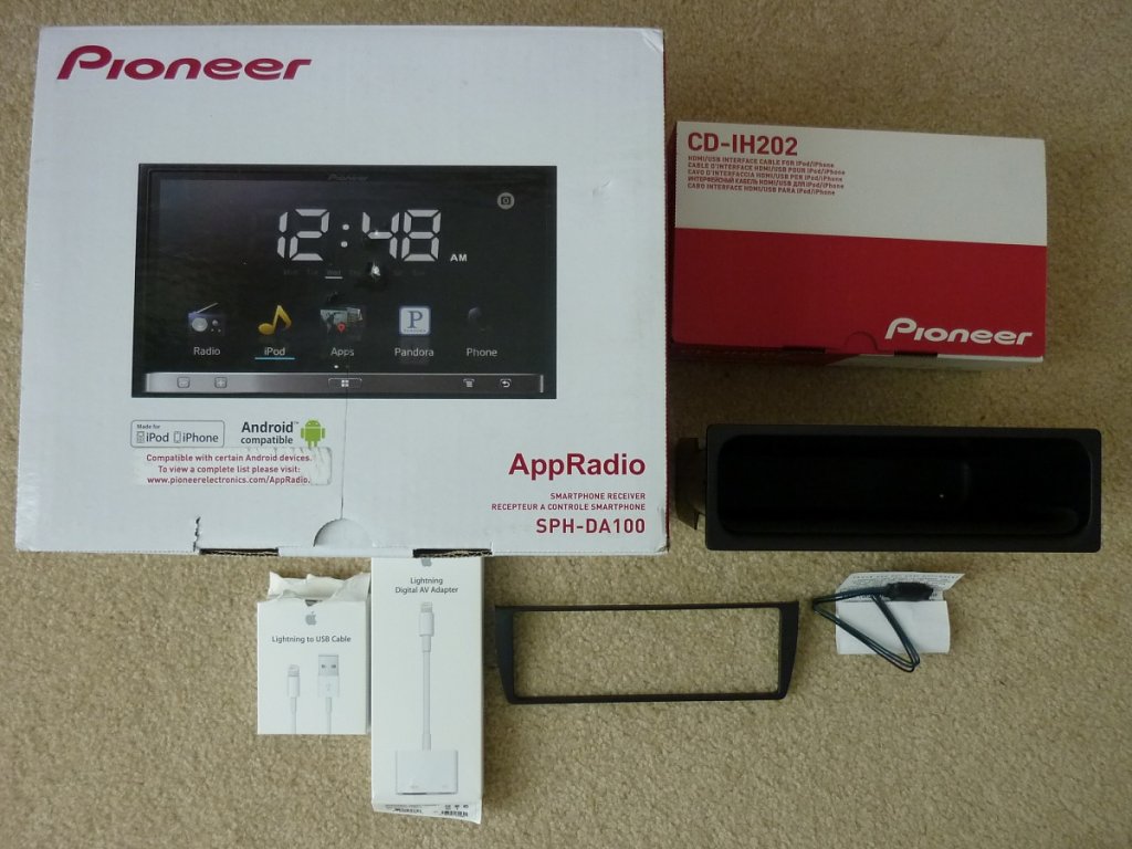

No inputs for ipod/iphone with this setup. I decided to go with the following to take advantage of iPhone 5 features (nav, siri, music, apps)

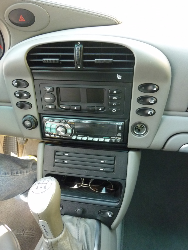

Will move AC to lower console. Here is everything needed with costs to support iPhone 5.
- Pioneer AppRadio2 SPH-DA100 ($211 amazon after rebates)
- Pioneer cable Kit CD-IH202 ($60 amazon)
- Apple Lightning to Digital AV Adapter ($50 amazon)
- Apple Lightning to USB Cable ($20 amazon)
- Parking brake micro bypass ($25 amazon)
- Square storage shelf 996 552 253 01 01C (as AC will move into lower spot) ($50 bumperplugs)
- HVAC trim / bezel 996 552 339 00 01C (as shape at lower section is a bit curved) ($7 dealer)
- Install cost and installer will make custom trim that goes around the AppRadio2 unit.
- Also required is the February 2013 firmware v8.30 - this adds support for iPhone5.

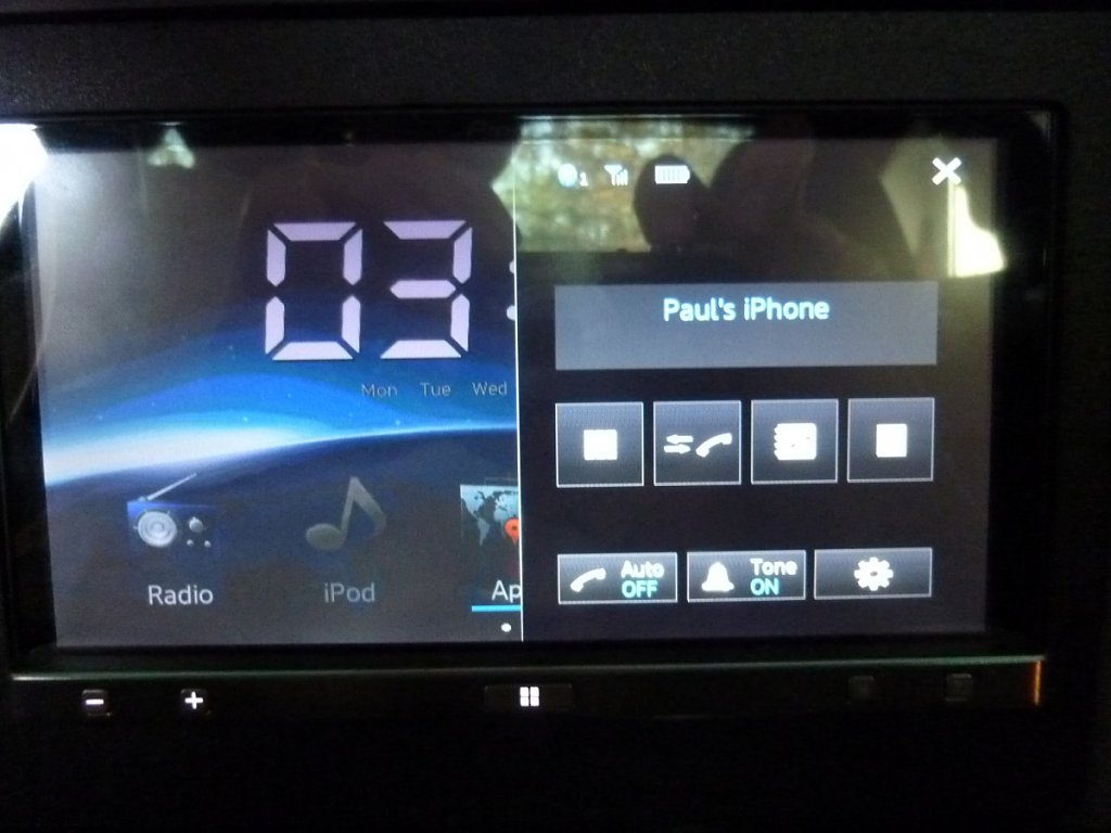

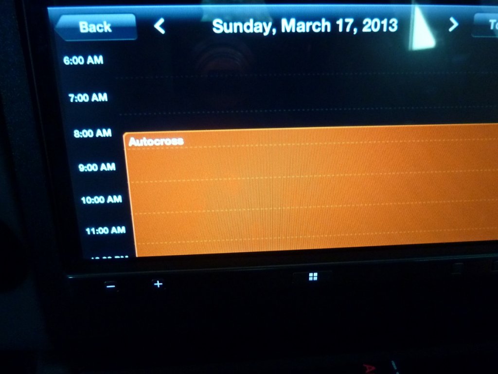

So I got the install done. I cannot really judge yet how I like it as I have not played with it much. After I got my car back, I had to update the firmware in order to recognize the iPhone 5, worked fine.
Now I just need to spend some time with it (I'm not good at reading manuals)

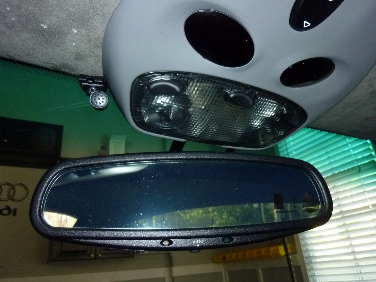

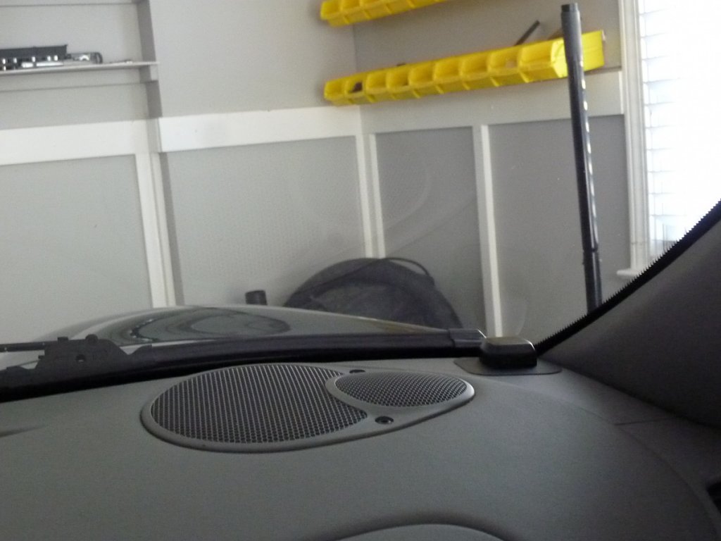

Worst part is this - the cables from the AppRadio USB port to the plug to connect the iPhone is like 2-3 feet of cable, some of it bulky. You really need access to it in case you ever have to apply a firmware update. This is all in the shelf compartment and occupies just about the entire space. I don't like this at all - I'm going to go back and see if they can redo. Maybe locate it in the glove box.
You can also see where they located the microphone and the antenna - I'm not sold on it yet, I like stuff concealed.
