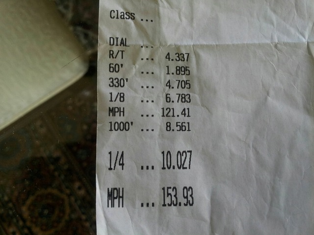

I never took my 4.5s up against the gt2 RS ICs on same car same day same conditions... so do not have a honest opinion... but I do have dynos with 800 to 1100whp set ups and even ran a 9 sec. 1/4 run in 95 degree weather ( NO METH) which is still the only non tuner car in the world to do so only second to evoms car...
I have logged a car or two with the .2s but on mild systems... they cool well. The question, if any, is do they add HP... there is a formula to actually figuring that out... Unfortunately I have a business to run and cannot get into debates as well.. We sell molded one piece end tanks, we cnc our flanges per hoses used, we use bell cores( no hidden stuff here), and pressure test them to 35 psi on the bench before they are shipped.. ( also have made major upgrades since we first started to sell them).
I've had a recent client that actually had 2 different sets of the .2s blow up on him... so maybe thats the reason for some remarks... I often tell others to " at least get the .2s if you cant get the others)...
regards
markski
ps. my car with 6" ICs just trapped 121.41mph in the 1/8th and 153.93 mph in the 1/4 and its summer... that speaks for itself...
2001 996TT 3.6L and stock ECU
9.66
seconds @ 147.76 mph 1/4 mile
click to view
