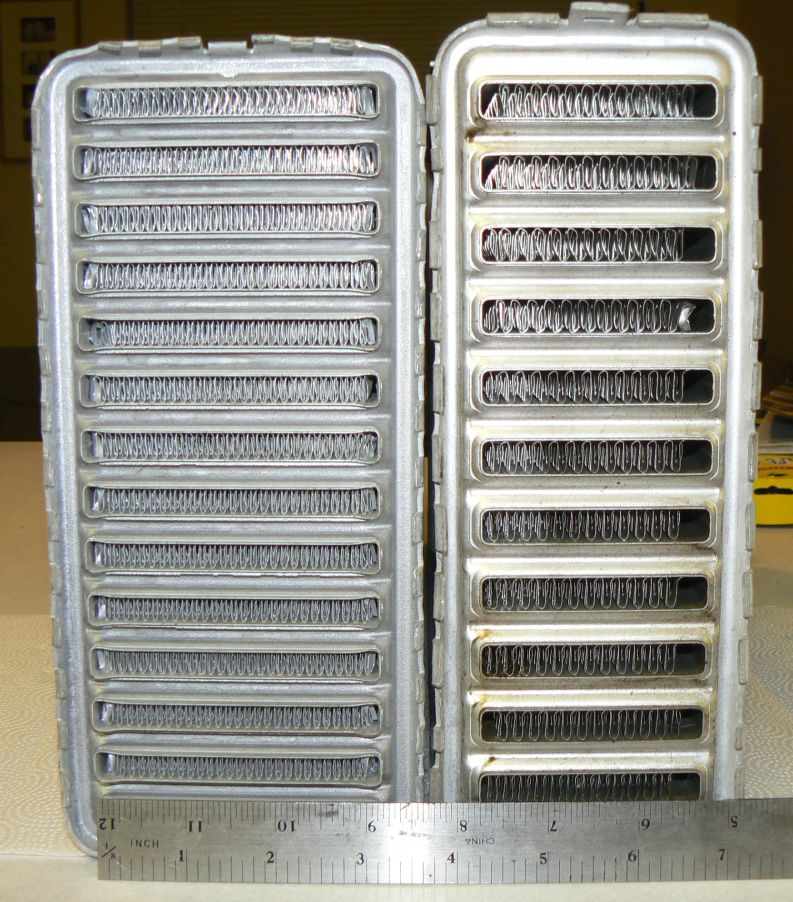

Intercooler upgrade are a must you will heat soak.

Forgot to mention that I have the 997.2 intercoolers.

I would have gone with bigger ones there ok the 997 ones but there only 2.5 inches you really want 3.5 or 4 inches.
They are 3.25" cores.

997 intercoolers are restrictive already seen the test and no they are not 3.25 there less then 3inches i have them in front of me. One run in heat and after that you will be heat soaked.
brnrdtns, target AFRs should be 1.0 on the lambdas (14.7 AFR on gasoline) at idle.
997.2 on the left. Not a restriction in the least on a mild 18g build. Would you like to see the independent flow testing I payed for?

There both restrictive they have plastic on both ends of each intercooler and no there not good enough for the 18g. I ran them i know. It was a complete waste for to put the 997 intercoolers on.
