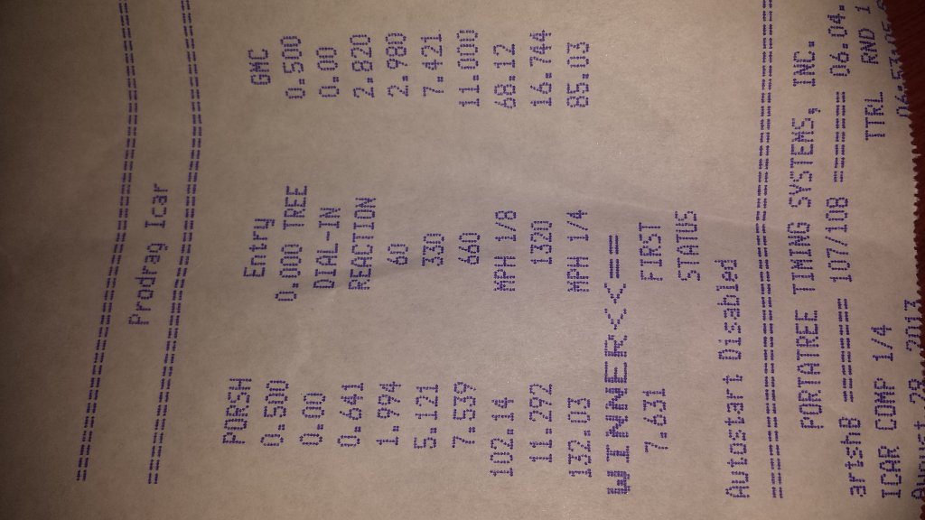

hey guys,
so last night I went to the track and tested for the first time my beast ! my goal was not braking an axle but test my trap speed only ! overall I'm happy with my time but i think i should see more like 133-135 mph with that kit especially with last night track condition
car setup: -250 lbs a28 GT700 kit , rwd conversion 94oct pump , bridgstone 305/30/19 re-11 at 35psi no heat up so yeah tire spinning lol!!
track condition: flat track, 240 feet above sea, 75f, tailwind around 4mph ,pressure around 30 inHg, 70% rh
video link: http://www.youtube.com/watch?v=CS-A6...ature=youtu.be
your input is appreciateClick image for larger version

Hey, good run. 35psi is prolly a bit too much rear tire pressure at the drag strip. If you bring that down, you'll hook better.

Everything looks good to me, 60ft, et, trap... Considering the mods, gas, conditions, launch, etc Good time for the second half 1/8 as you were running pump gas - 1.4bar i assume. Rwd and general weight reduction helped a lot. Congrats !

my goal was not getting the best ETs! but trap! putting down the tire at 22psi would put alote more stress on tranny!

I didn't say 22psi, I just said to lower it. 35psi is waaay too much. 132 trap is stout. Your car is strong.

35 psi of air int tires is too much. at least drop it down to 28psi and doa quick spin before you launch. 1.99 60ft is not good. your car can run high 10s at 134-135 the way it sits with a better launch/pass.

prodigymb 35 psi of air int tires is too much. at least drop it down to 28psi and doa quick spin before you launch. 1.99 60ft is not good. your car can run high 10s at 134-135 the way it sits with a better launch/pass.
right i know that!also soften the rear suspension help a lot to sit! but my concern is the stress putting down on rwd no lsd ! what its limit capacity??

If you can get that 60' time down to 1.7's you should break into the 10.90s,,especially with your MPH..
