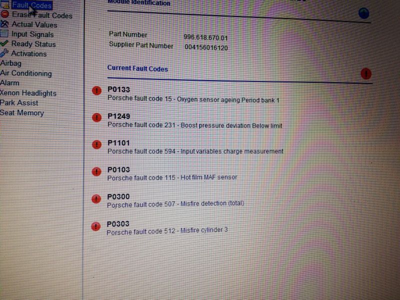

Posting for a friend found this codes, ordered maf to start with that

Looks like you have more then a MAF problem but hot film is a bad maf senssor or its going.

New MAF, New Plugs, New N75, New MAP sensor, air leak test, vacuum hoses all correct, tried the car with straight pipes hoping for a bad cat... . All codes are gone still getting that throttle doesn't respond immediately from idle...slight hiccup hesitation.
Any one Please

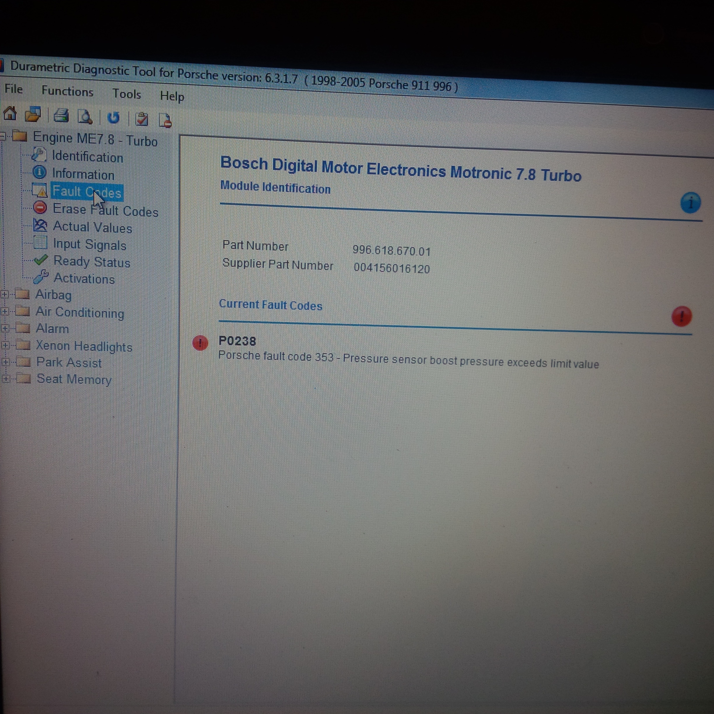

ID:	338994New code Help please. Already tried new N75

How much boost are you running? sounds like your over boosting into limp mode......
Old Feb 25, 2014 | 04:01 PM
Because_R4CEC4R's Avatar
Joined: Oct 2013
Posts: 122
From: Ontario, Canada
Because_R4CEC4R has much to be proud ofBecause_R4CEC4R has much to be proud ofBecause_R4CEC4R has much to be proud ofBecause_R4CEC4R has much to be proud ofBecause_R4CEC4R has much to be proud ofBecause_R4CEC4R has much to be proud ofBecause_R4CEC4R has much to be proud ofBecause_R4CEC4R has much to be proud of
^^ what he said. That sounds very tune related. Maybe a fuel system issue causing it to lean?
