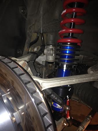

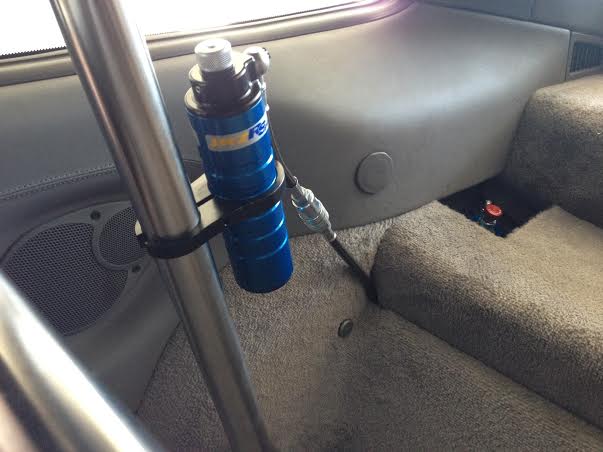

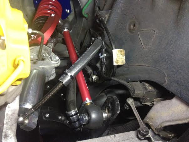

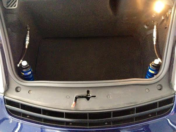

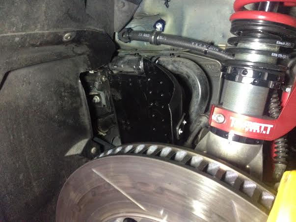

I recently installed a set of JRZ Pros with remote canisters and quick disconnects. I took some picture of the installation in case someone tackled this in the future. The rears are pretty straight forward as I routed the hoses through the existing ABS grommet near the shock towers. It's very easy to enlarge the grommets with a razor blade. I then attached the canisters to the roll bar behind the front seat. The fronts take a little time as you have to make sure the hoses do not bind anywhere during the full steering angle. I ended up doing the front a little differently as most people route the canister to the battery area and attach them to the cross braces. I could not mount them there as my car has an additional RUF strut tower brace in that same area. Plus, I did not want to have the canisters exposed to the elements and decided to mount them in the trunk area where they are easily accessible for compression adjustment (rebound is adjusted at the top of the shock). I ended up drilling a hole in the forward part of both wheel wells (don't forget to install grommets to seal the holes and prevent chaffing the hoses) and routed the hose through there and around the ABS pump on the drivers side. The passenger side is largely open although some cars have an auxiliary Bose amp there. I then zip tied the canisters to the trunk liner tucked neatly away in corners of the forward portion of the trunk. For further protection of the hoses, I bought about 10' of 7/16" ID fuel line and cut it open lengthwise with a razor. I then slipped the fuel line over the canister hoses and secured with zip ties. Worked like a champ. With this installation, it is very easy to adjust compression of the rear shocks by simply reaching behind the front seats, and the fronts by simply opening the trunk. I also put a hole in the front shock tower dust covers and so that front rebound adjusters would be accessible for adjustment with the covers in place. I cut open a small piece of fuel line along it's length and placed it around the edge of the opening. This effectively prevents water from running down onto the upper mounts.

Is that the Porsche Tequipment rollbar? If it is, I have the same. I wish it'd tie to the rear shock towers rather than the seat belt mounts, but... whatever. For the mom at least.
Do you have any issues with the seat adjustment? I am 6' and have the OEM GT3 seats and a pair of 997 sport seats that I might swap in for longer drives. Or maybe not. I read somewhere that it is tight.

I'm 5'10 and have no issue with the seat adjustment. When adjusted, I have about 6" of room between the seat back and the cross bar. In other words, plenty of room. I am however using Recaro Spa seats which have a very narrow and thin Kevlar shell and are nowhere near as bulky as the stock seats. The Spas only weigh 8 lbs each.
